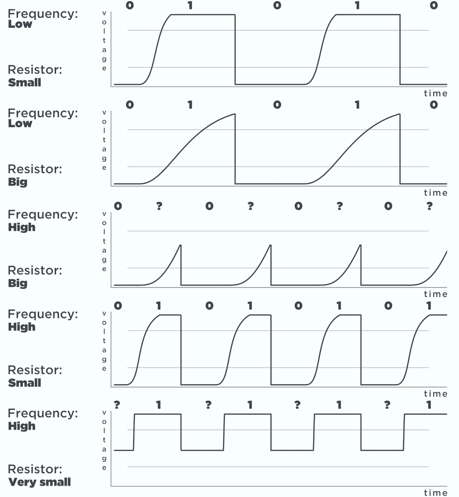

So after I couldn't make it work like that I did end up following your tip from my previous post and tried making only the Master Receive work. However, I still had no luck as my clock line for some reason gets pulled low when I add a second board even though I am using pull up resistors.
When I try using the Master board by itself the clock and read and write requests work as well (though they don't get acknowledged since there is only one board connected).
To look at what's happening I am currently using the terminal for printing and a Logic Analyzer.
What "second board" ?
Have you tested your Master with a known-good, simple slave - like some standard, well-known I2C chip?
At this stage, an oscilloscope is probably better, as you can see any analogue nasties - such as wrong pullup values.
By putting a resistor in series with the lines, you can see which end is doing the pulling-down ...
"an oscilloscope is probably better, as you can see any analogue nasties - such as wrong pullup values"
For example:
0693W00000Nt1crQAB.pnghttps://electronics.stackexchange.com/questions/1849/is-there-a-correct-resistance-value-for-i2c-pull-up-resistors
