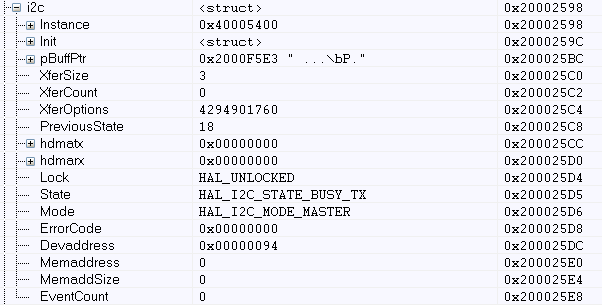

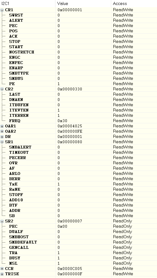

The I2C initially works fine and the MCU is perfectly capable of communicating with the peripherals. The issue is that, eventually, the I2C gets stuck in the HAL_I2C_STATE_BUSY_TX state. Since i'm using IAR, I can observe the state of the I2C register and the internal object, as follows:
0693W00000QNQQFQA5.bmpand
0693W00000QNQQKQA5.bmpThe interesting thing is that the registers indicate that a transmission operation is ongoing, but in the internal object XferCount is zero, indicating that everything was transferred. It's like the closing steps never happened (and I checked the interruption with a breakpoint and it is never called).
