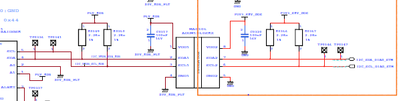

it's  a better schema i think !
Better - we can see that the pullups are properly pullups - but too low resolution to read any of the text.
Again, have you tried this without the isolator?

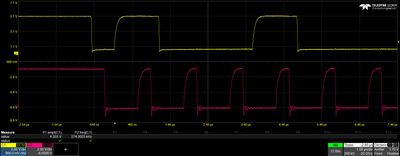

Mnfz
This is a visualize simultaneously signals on clock and data lines , I notice a desynchronization between the data
and the clock, it seems as if its the source of my problem, data frames are not cached due to this  is that correct ?
As for signals shapes, i think there is no problem related to Pullups, what do you think?
Is that before or after the isolator?
Again, does it work without the isolator?
