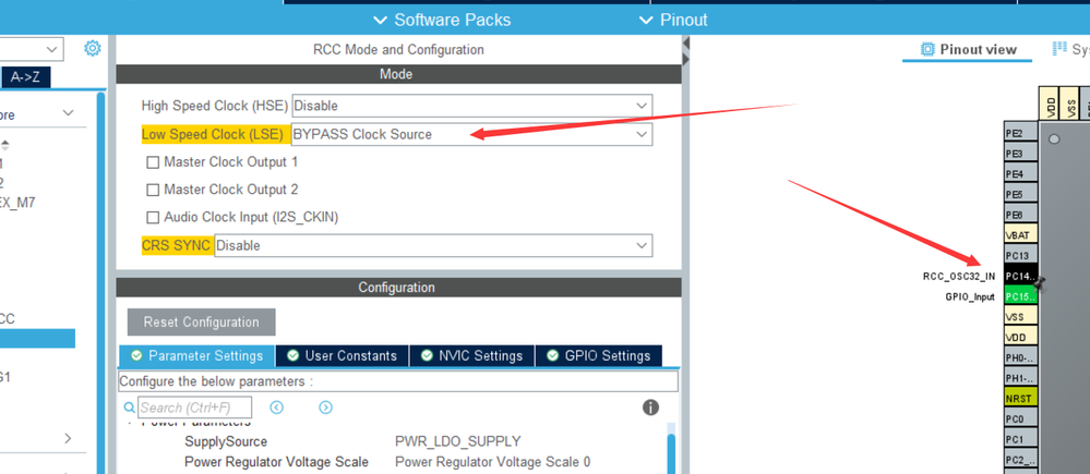

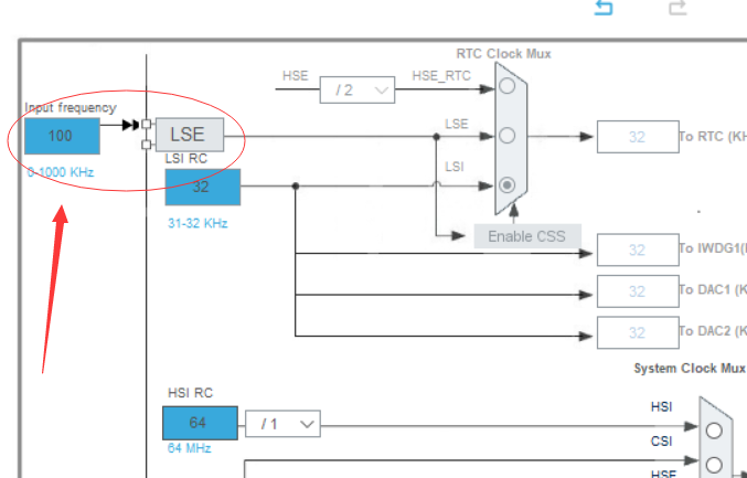

I use 100Khz oscillator for LSE on STM32H7B0VBT6 but LSERDY cannot work
kgai
100khz Oscillator for LSE input. The OSCillator works right bcz I test the waveform by scope.
but stm32h7b0vb cannot get lserdy bit set.
Seems I m the 1st Person meet the situation.
plz help me. Thanks.

new info: I change the Oscillator to 32.768Khz and it works well.
so conclusion is the STM32H7B0 LSE cannot use freq other than 32k768. the datasheet is wrong about it.

it is sure Oscillator , Not crystal. I set the bypass

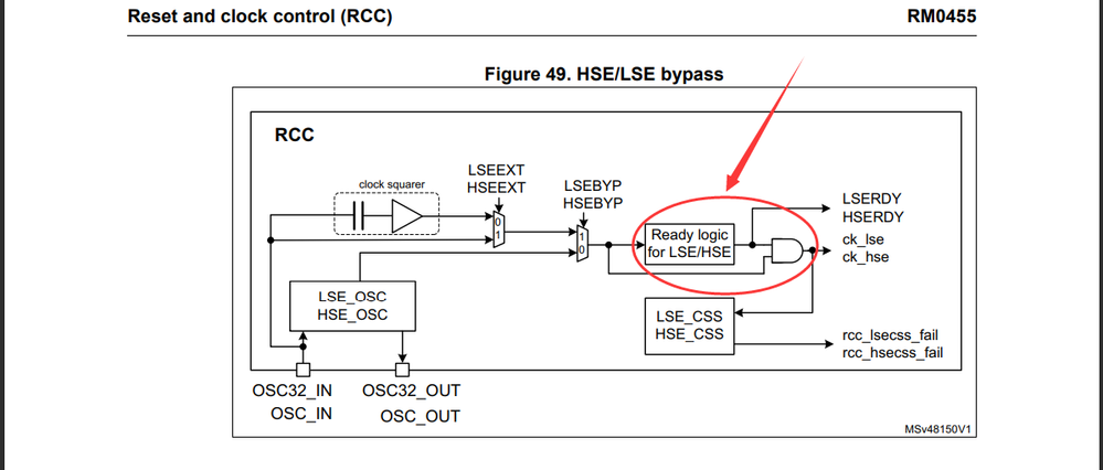

The primary purpose of LSERDY is to make sure the crystal starts to oscillate before proceeding with setting up other things. If you are sure your external oscillator is oscillating, you can simply avoid testing LSERDY.
Thank u anyway!
but things are not that simple. Look at the pic below. I will explain it.
the "ready logic" module inside the red circle is very important, bcz follow it there is an "AND" gate, while the "ready logic" or "LSERDY Bit" output 0 then we will get CKLSE out always 0.
so we cannot ignore the Ready bit.

I fix the problem. THANKS
the Reason is I must call LL_RCC_SelectDigitalClock after EnableBypass.
now work well.​
