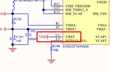

I wanted to set up time keeping on my Discovery board for testing something.
I see the following in the documentation for the larger STM32F769-EVAL:

But the first line from the docs makes me think there has to be an RTC on the -DISCO board. I take it I need to put a 3.3V battery somewhere. In the diagram I see a number of 3.3V connected things, but most are related to ST-Link. It's totally unclear to me where I would need to connect a battery, and how to know that it'll only power the RTC (if there is one)
The diagram I'm looking at is at page 40 in the manual, here:
https://docs.rs-online.com/9ce5/0900766b81693555.pdf
I'll take off the LCD later and search the board for anything that looks like an oscillator or clock chip, but I also searched the manual for "RTC" and found nothing. If there's none I also don't know how to best add it - there's a header for WiFi (ESP8266) or I2C. I got an ESP8266 around so I was gonna use it. I don't know if an RTC could be added to the same I2C interface?!!!

Hello @darkfader and welcome to the ST community,
The MCU itself (STM32F769) has an RTC but unfortunately the VBAT pin is tied to VDD in the PCB on STM32F769I-DISCO as shown in the board schematic:
Contrarily to the EVAL board that has a battery socket.
I know this is a limitation I've already faced on one of my projects and asked to make VBAT accessible over jumpers or at least a solder bridge for future STM32 boards.
So in your case you need to use an external RTC chip over I2C, with a time saving with a battery.

edit: I looked at the board a bit and the lines are so thin I'll not attempt anything anytime soon. I2C it is.

There is a tiny little hole in the PCB next to R108, maybe they already went one step into your direction.
