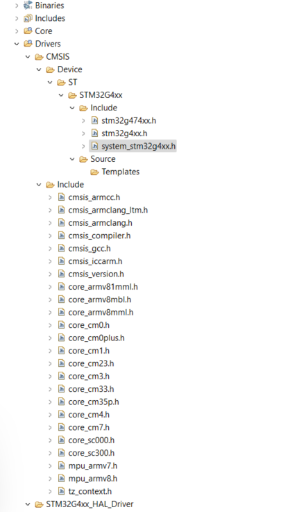

Thank you for your response. If you don't mind me asking where can I find CubeG4 repository or CMSIS directories with DSP code?
I searched within my project's folder structure and within that, I could not find it.
