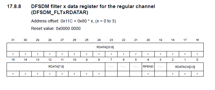

How are you trying to use it? It's meant for transferring data from a peripheral, e.g. the ADC, to a double buffered memory. In this case, you would put "&ADCx->DR" as the source memory address. Not StreamBaseAddr.
TC interrupt is called when the transfer to the first buffer completes, then again when the transfer to the second buffer completes, and so on. HT interrupt is not enabled.

canbu22
0693W000000XKYJQA4.pngmay be the data register of the DFSDM filter should be the Source address :
