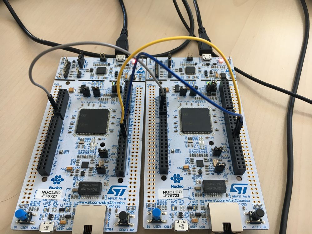

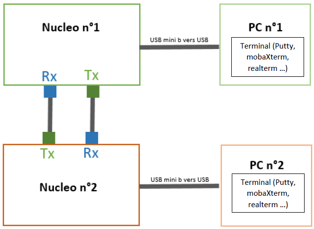

I'm a beginner and i'd like to start with STM32, and use uart protocol to communicate between two F767ZI cards (sorry for my english)... ^^
I use STMCubeIDE, downloaded stlink009.
I saw lot examples on other stm32 without result when i code something
‎2020-07-09 8:16 AM
Moreover i understood that printf function is so complicated to be used.

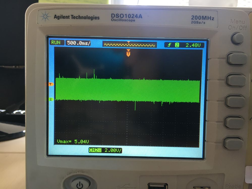

I'm using an oscilloscope and LEDs to test my code and functions.
GND pins are connected too.
TO begin, i only transmit from one card to the other one with the function hal_uart_transmit as shown as below :

Have a common ground lead. While I suspect the USB might get you that, I'd prefer to see a board level bonding.
Neither of these transmit or receive functions will call the callback, they basically poll/block.
The IT variants on the other hand drop through, so you'll need to guard against calling them with data in-flight, but they would call the callback when the transfer is done.

I added a ground cable between the nucleos (the result is the same).
