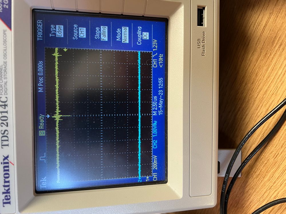

So far I have checked VCAPs and voltages.
I have these currently fitted https://spicat.kyocera-avx.com/product/mlcc/chartview/08053C225KAT2A.
And have now ordered some of these https://www.murata.com/en-eu/products/productdetail?partno=GCM21BR71E225KA73%23 which have much lower ESR.
The pin voltages are correct but I am seeing some reasonable spikes on the scope trace, so my thinking is that maybe it's this. Hoping the lower ESR capacitors will improve the situation.
