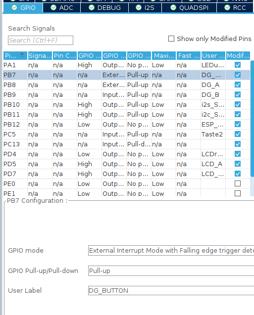

‎2023-05-07 10:26 AM - edited ‎2023-11-20 6:13 AM
ad 1: set rising/falling detection on 4 or more pins , as you like ->
then process in INT , count++ ... timeout , etc.
ad 2: shure, it will make an int also, but ... why create complex setup, just to get a pin change level ?
