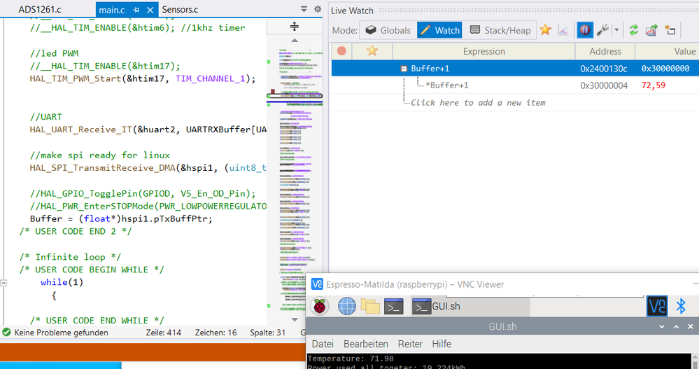

if I am watching the TXBuffer, there actually is the correct value inside and it changes with time. The first value I got was another than I could see in the buffer (it was the old one from the last time I used SPI)

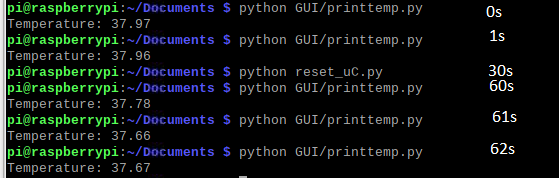

Some additional information.
I tried to following to make sure it is a problem I am having with the microcontroller and not the raspberry.
I heated the element a bit, so that it cools down to have a decreasing temperature. The values I get have a noise in the range of 10mK, so two consecutive measurements only differ by 0.01.
I took two measurements to make sure I got the real temperature. Then I waited ~30s and resetted the microcontroller. After additional ~30s I read the temperature two times. The first temperature I got was between the first one and the last one. This somehow prooves that I got the value from when the micocontroller was resetted.
