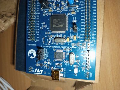

2025-04-26 11:00 AM
Hello @Duc_Tran and welcome to the ST community,
Make sure all these components in the RED recatngle are available on your board:
If you are using CubeMx or CubeIDE could you please attach your ico file?

i was trying to fix it but still not working, the board does have all the components, here is the full code and
