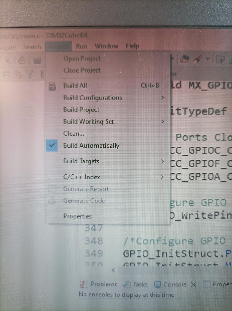

if you meant this, i couldn't find that option "Project Manager"

Not in the STM32CubeIDE, but in its sub-function STM32CubeMX, which is also available as a stand-alone programme.
To start this, double-click the IOC on the left in the Project Explorer. In the CubeMX window that appears, the Project Manager is the third tab from the left, and in the left-hand column you will find the Advanced Settings.
