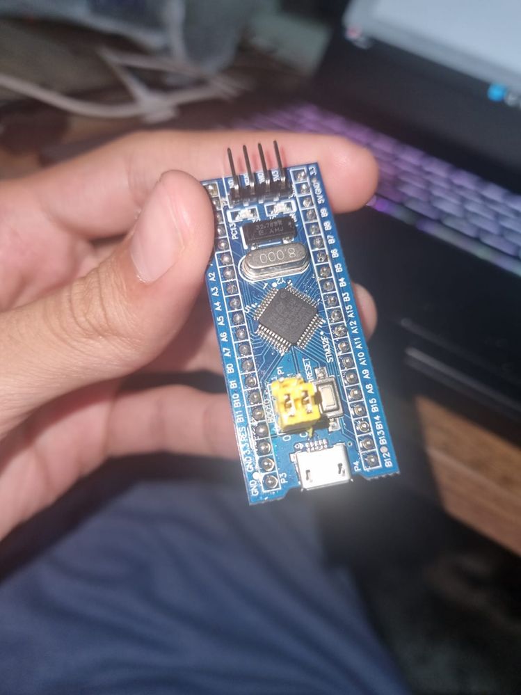

I NEED to toggle PC13 led with button in stm32f103c6t6
Propiyonat
I'm a starter in embeded systems and my teacher told me to write a code for this stm32 and add a button to in on breadboard then it needs to toggle with it ( one push on button turn on the light r5 or pc13 and another push to same button turns off the same led ) I'm sure its a easy task to do but as a person don't knows anything about writing a code or work with embeded systems i couldn't find it anywhere i hope someone can help me with that (also i bought a udemy course too but it starts all started its good to learn but i need to do this in hurry. I've been working on it like 2 or 3 days and how fast im complete how good its going) Thanks All Of You !!!WhatsApp Görsel 2025-06-02 saat 20.01.47_70f33385.jpg

Andrew Neil
That's a so-called "BluePilll", so (almost) certainly contains a fake STM32.
Your teacher would do better to get you Nucleo boards - which come complete with a button, and a built-in ST-Link.

The cpu on your blue-pill looks genuine, as far as i can see it on your pic, so it should work with an st-link .

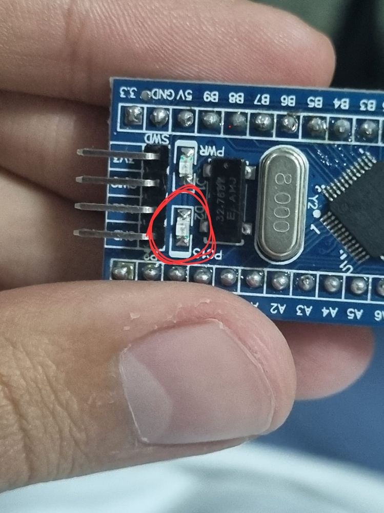

not an another led . led on board which is connected to pc13 which is blue (there is only 2 leds red and blue) i mean.
so..you cannot read.
in the link -> the led to pin#pc-13
Toggle LED on PC13

     /* GPIO Ports Clock Enable */
     __HAL_RCC_GPIOB_CLK_ENABLE();
     /*Configure GPIO pin : PB0 / PB1 for buttons to GROUND */
     GPIO_InitStruct.Pin = GPIO_PIN_0 | GPIO_PIN_1;
     GPIO_InitStruct.Mode = GPIO_MODE_INPUT;
     GPIO_InitStruct.Pull = GPIO_PULLUP;
     HAL_GPIO_Init(GPIOB, &GPIO_InitStruct);
    while(1) {
        if (!HAL_GPIO_ReadPin(GPIOB,  GPIO_PIN_0)) // PB0 = LOW, BUTTON PRESSED
          HAL_GPIO_WritePin(GPIOC, GPIO_PIN_13, GPIO_PIN_RESET)); // LOW = LED ON
        if (!HAL_GPIO_ReadPin(GPIOB,  GPIO_PIN_1))
          HAL_GPIO_WritePin(GPIOC, GPIO_PIN_13, GPIO_PIN_SET));
