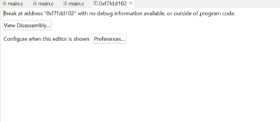

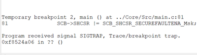

I am using the B-U585-IOT2A board based on STM32U585 and am configuring TZEN and checking some sample programs. i am not able to reset the board either through the push button or through the software code "NVIC_System_Reset()" and when debugging am getting a break error as shown below:
The debgug console is returning the error:

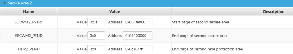

On searching the community i found that there is some error in the memory configuration of the secure and non secure area. the linker script i have used is the default one that stmcube mx has generated. the option byte i have used is as below:
The issue is i can run my program only once(functionality works) but neither am i able to reset or run the program again while debugging again.
please assist me in solving the issue.

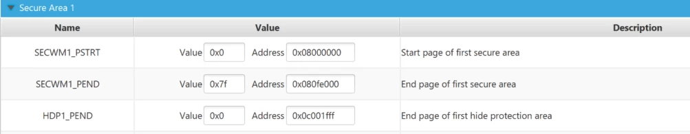

  • Are you sure about the start and end address of secure area 2 ?

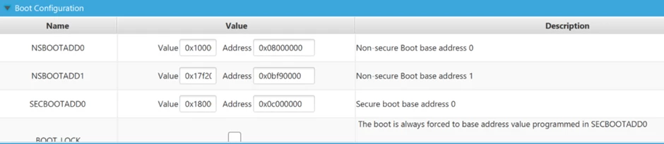

  • What is your boot configuration and your OB values ?

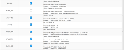

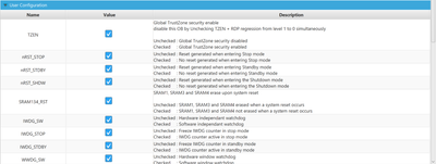

Following is my option byte configuration(boot Configuration)

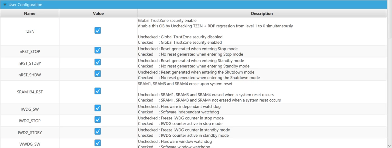

User Configuration Option Bytes
I am attaching the Linker script for both secure and non secure code.

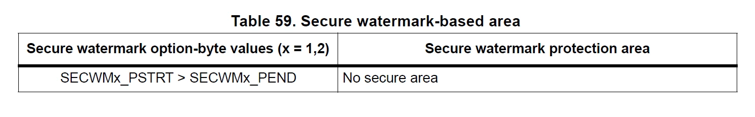

I have changed the secwm2 option byte value like SECWM2_PSTRT>SECWM2_PEND from information got from the community(Sorry not able to recollect exact reference)
I tested the GPIO_Toggle_TZen code from STM32U5 package with the above configuration.
Please let me know for any other information that is required from my side.

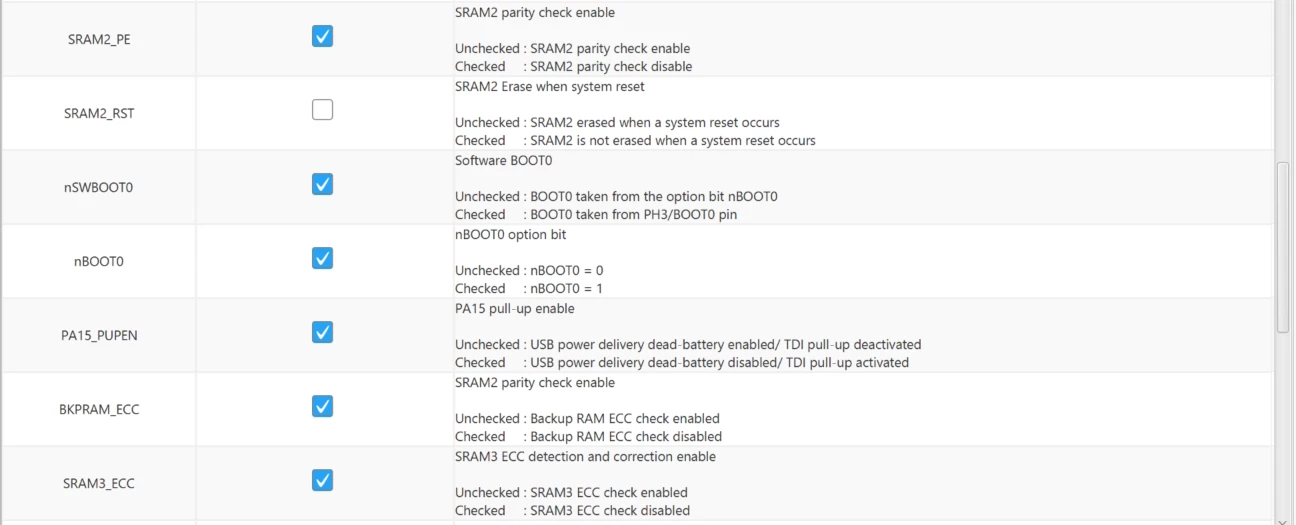

As the Embedded flash memory (FLASH) chapter of the Reference Manual describe :
  • All your configuration seems correct but why did you uncheck SRAM2_RST ? The RAM_NSC is stored in SRAM2. That can be a part of the problem.

Hi @Pierre_Paris
Thanks for your update

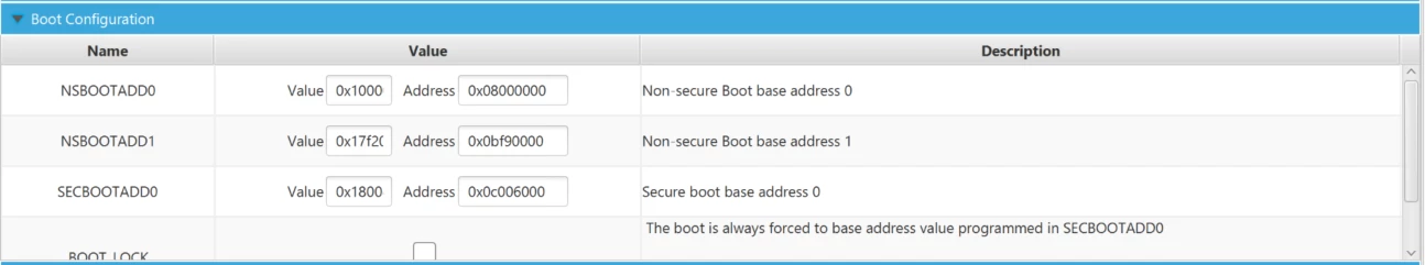

At last was able to find the solution. The problem was the address configured in the NSBOOTADDRESS0. There was a wrong value given. I modified the values to the following:
Now that issue is solved.(SRAM_RST is checked) that was unchecked while testing the TF-M SBSFU Application.
Now i am able to reset the board and is able to debug multiple times. Now the example code and my code is working fine.
