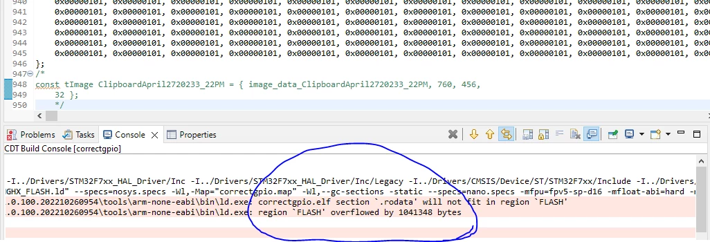

Hello everyone ,
I am Yugenthar
Right now i am working in embedded development platform . So i have one doubt guys.I have using stm32f746-disco board.
I am displaying one image in LCD screen (800x760)so pixel size is incresing.
my code is runing in flash memory
my compiler is show one error "your flash is overflow"
then I have decided move to SDRAM and store my code
But I have not perfect in SDRAM so any one give the sollution any material or tutorial link

EDIT: sorry, you want to know how to use the external RAM on the disco board...
What about starting with calculating how many bytes you need, and then compare to the controller's spec?
If your data is too big, you might need external RAM or flash.
From your screenshot: definitely you need some external memory...
Isn't there anything on that discovery board?

When running out of Internal Flash the External QSPI Flash would be where to park large graphic resources. Would need to select an External Loader to download data to it, and then App side code to bring up the pins and memory interface.​

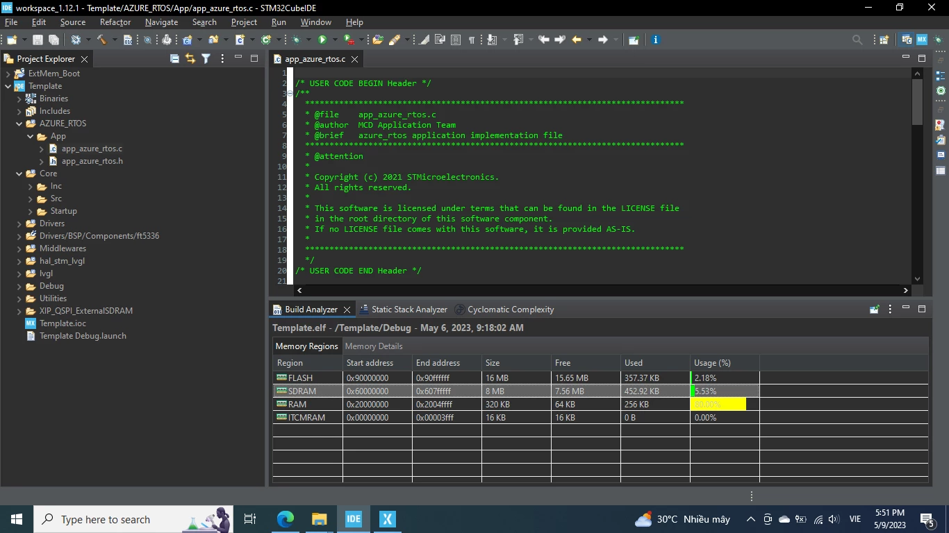

OWLchan
May 9, 2023
do you want to use sdram to put that image on screen, or use external flash to save it??
i just found a nice example, that can use both external flash and sdram, but it is stm32f7508 dk same as my board, hope it helps you 
put the image here and try to compile it 
Mula-Gabriel/STM32F7508-DK-LVGL-AzureRtos-Template (github.com)
