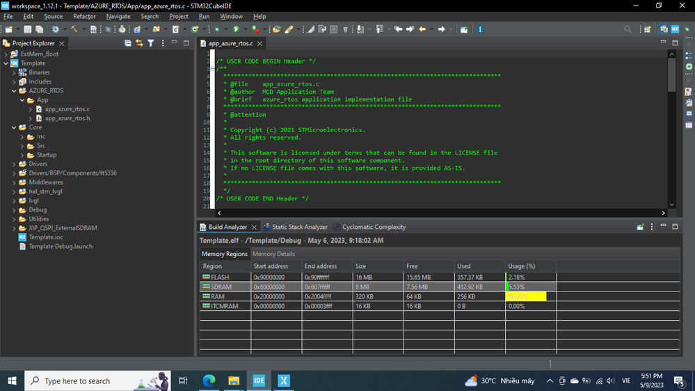

do you want to use sdram to put that image on screen, or use external flash to save it??
i just found a nice example, that can use both external flash and sdram, but it is stm32f7508 dk same as my board, hope it helps you 
put the image here and try to compile it 
Mula-Gabriel/STM32F7508-DK-LVGL-AzureRtos-Template (github.com)
