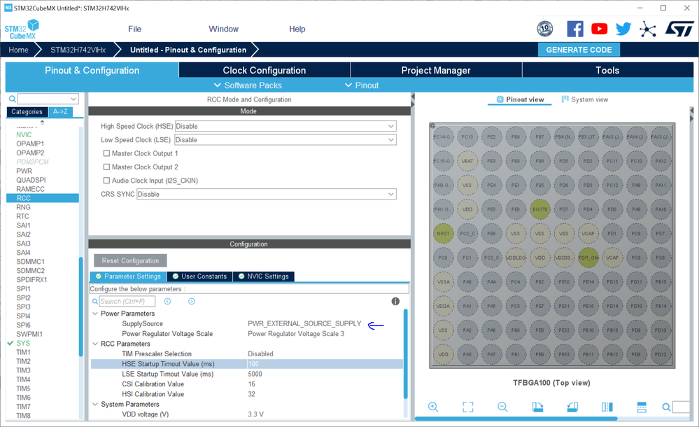

Hello @mwb​,
I invite you to check this article for power supply configuration
Unable to connect to STM32H7 devices
You can find the configurable parameters in CubeMX in this screenshot0693W00000WKdDgQAL.png
Best regards,
FBL

Hello again @mwb​,
Power is configured once after POR; it cannot be changed. You need to perform power down then power up to switch to a new power mode.
Best regards,
