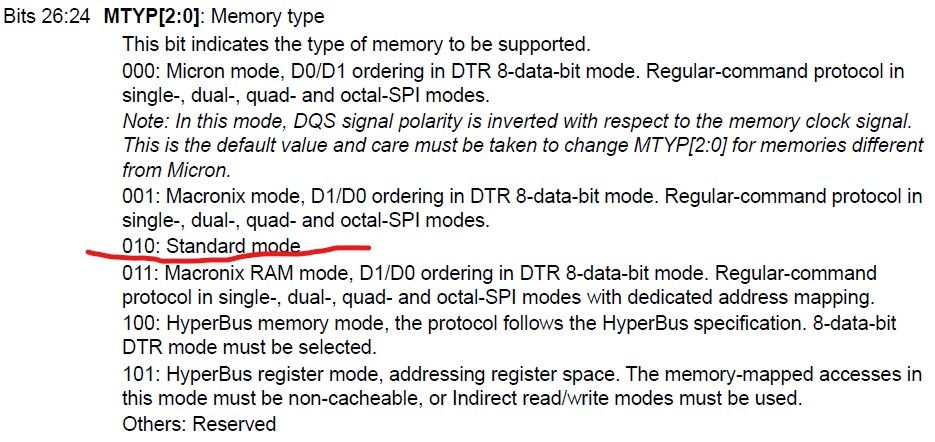

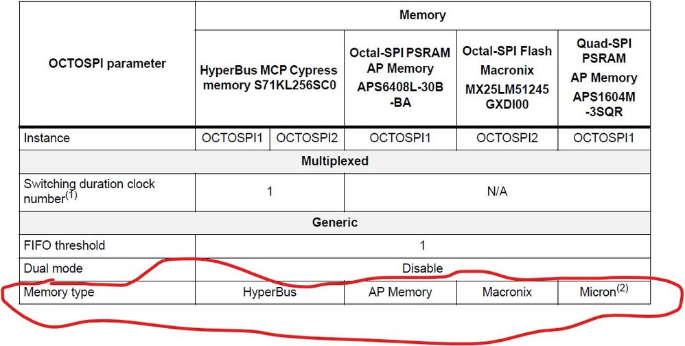

1.in the manual "AN5050", What's the meaning of "memory type"? Does this mean that OCTO only supports these four types of memory chips? The flash I used is "IS25LP064A", Does the OCTOSPI support this flash?

MTYP: See RM of your MCU, in particular OCTOSPI_DCR1.
DEVSIZE: no, as indicated above, 23 would be adviseable.

For SPI flash the memory type (macronix vs. micron) is relevant only in Octal-DTR mode, it affects the byte order within one clock cycle.
As your chip is only SPI or Quad-SPI, the setting of type (macronix/micron) doesn't matter, i.e. MTYP should be 000 or 001.
Regarding DEVSIZE: In theory 22 would be correct as 2^(22+1) gives 8 MBytes. But due to a silicon bug (see errata sheet), it's a good idea to choose a bigger value, so 23 would be a much safer choice.
The IS25LP064A should be workable.
These other "Type" relate how the signalling works/sequences, and which player its most like.
Winbond, ISSI, Infineon should all work

ok, thanks, what's the meaning of "MTYP", and how to set it to "000" or "001"?
According to your explanation, in my source code "hospil.Init.DeviceSize" should be 22, right?

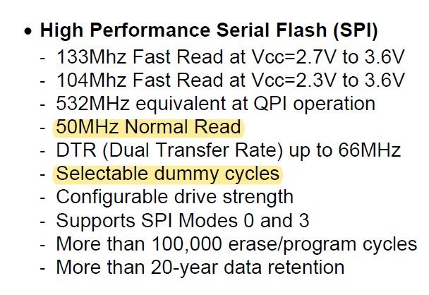

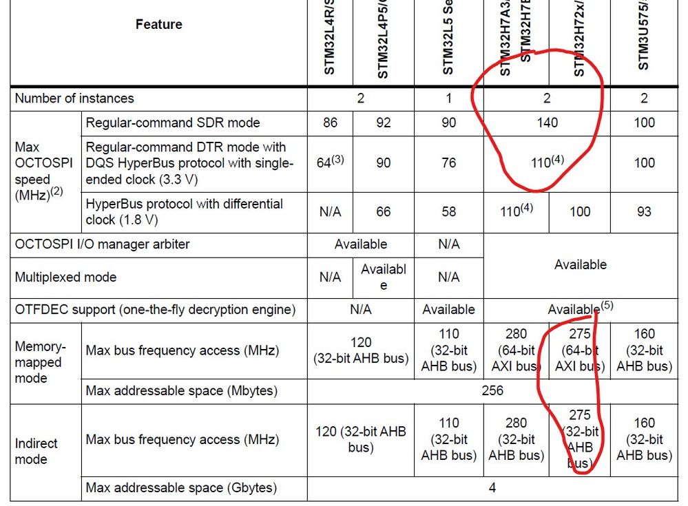

another question is how to set the frequency of OCTOSPI? what's the difference between "Max
OCTOSPI speed (MHz)" and "Indirect mode"?0693W00000WK9NWQA1.jpgand according to my flash, how to set the OCTOSPI CLK correctly?
If I use IS25LP064A How to select in the selection list of memory type ?
Clock: Well, take OCTOSPI kernel clock (as given by the clock tree and
OCTOSPISEL bit in RCC_D1CCIPR) and calculate the required divider to yield a clock below the flash's limit (50MHz in your case). If you're unsure (there are a lot of settings involved) check the resulting clock with a scope.
"As your chip is only SPI or Quad-SPI, the setting of type (macronix/micron) doesn't matter, i.e. MTYP should be 000 or 001.", for my flash-IS25LP064A, I think I should set MTYP to 010, do you think so?

  1. As far as I understand, 010 and 011 are both RAM modes, but like 000 and 001 only different regarding byte order in DTR mode. As I've used only flash / EEPROMs devices up to know, I can't say anything regarding these modes. For all devices I've used so far, mode 000 works.

Hello @rsun.1​,
Adding to all the contributors' comments, and for the frequencies presented in the Table 2 of the AN5050:
  • Max OCTOSPI speed represents the OCTOSPI interface frequency that should be respected when using the interface, you can refer to the product used datasheet
  • Max bus frequency access represents the bus frequency, as the OCTOSPI is an AHB/AXI slave mapped on a dedicated AHB/AXI layer. It does affect the performance of the whole application system speed.
