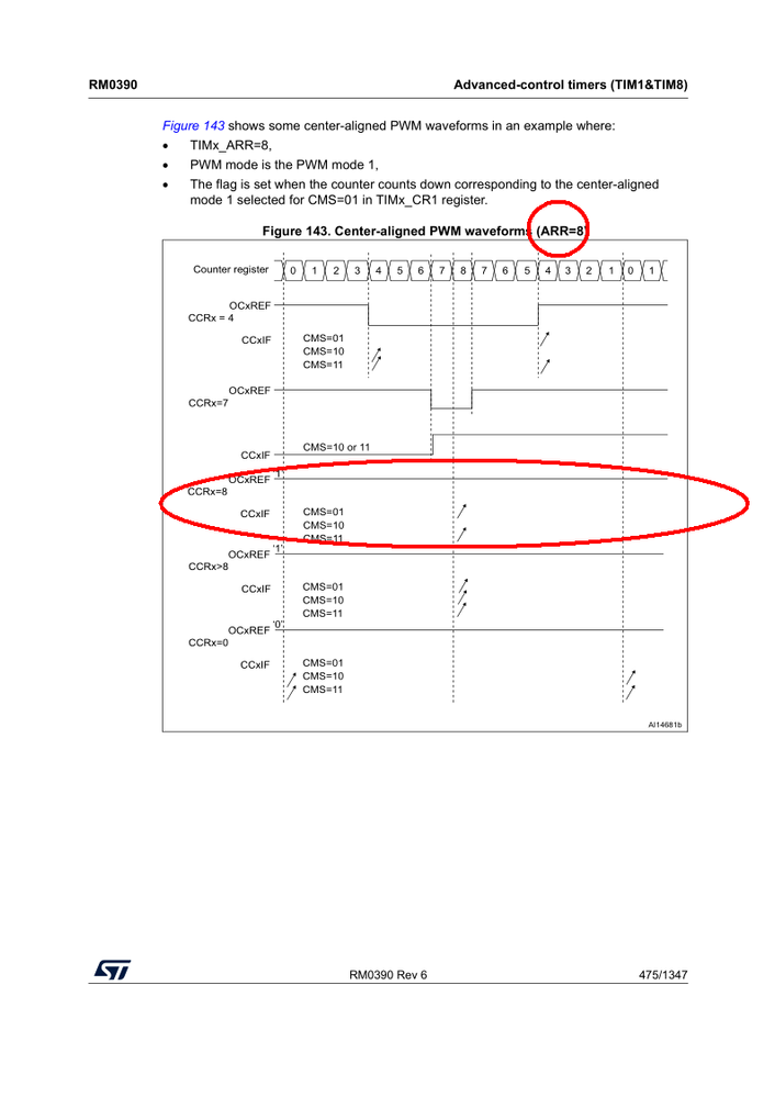

I'm using TIM1 to generate center-aligned PWM on channels 1-3 for motor control and wanted to trigger the ADC to read motor current right in the middle of the PWM cycle. To do this, I was programming TIM1->CCR4 to the same value as TIM1->ARR. I was getting CC4 interrupts (TIM1->DIER.CC4IE), so I thought everything was working as expected and TIM1 would generate the event that triggered ADC1.
When I changed TIM1->CCR4 to TIM1->ARR - 1 everything started working. So apparently if CCR4 is set to the same value as ARR, compare interrupts will happen, but not trigger events. Hmmm...
Thanks for the link to the STM32 Gotchas site. This issue seems to be covered by gotcha #31, but not exactly, because that gotcha implies that both interrupts and triggers will be generated. I'm seeing interrupts, but not triggers.

As I've said, the ADC is triggered by exactly the same signal which goes to the TIM_CHx pin. If you enable such pin and you don't see any edge - which you won't if you set TIM1_CCR4 to TIM1_ARR - the ADC won't get triggered.

111: PWM mode 2 - In upcounting, channel 1 is inactive as long as TIMx_CNT<TIMx_CCR1
else active.
The CNT register reaches the ARR value and stays at it for a period of one CNT clock cycle. Shouldn't the channel be active for that one cycle?
I agree, and that's what I would expect it to do. What was fooling me was the fact that it was generating the CC4 interrupt even though it wasn't generating the ADC trigger.
waclawek.jan
PWM2 is just inversion of PWM1.
IMHO it boils down to the exact moment when DIR changes, which is not drawn on these diagrams, unfortunately. But, honestly, I try to stay away from the up-down counting modes as far as it's possible.
