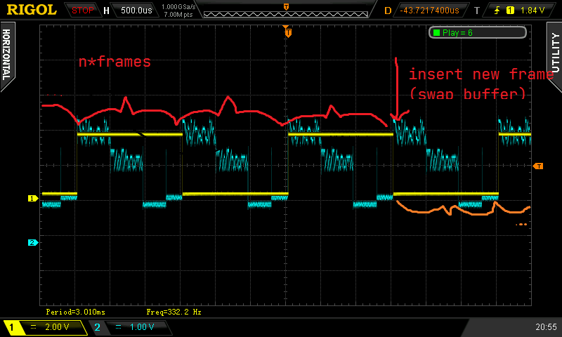

My intention is to swap a DMA buffer at the exact time a DMA Cyclical buffer ends writing it's sequence to the DAC. I want a seamless transition from writing the last DAC value out to the writing a new sequence (buffer) to the DAC... The buffer needs to be swapped at unpredictable times and has varying lengths.
In other words I want to commit the swap once the DAC has written the last value of n cycles and immediately after that.
viz the function - swap_buffer:
a. Executes at unpredictable times.
b. Changes the length and values of the DMA stream that is written to the DAC:
(stops the timer and DMA). Currently implemented in:
HAL_TIM_Base_Start(...) HAL_DAC_Stop_DMA (...)
before altering the DMA stream to DAC and restarting the timer
HAL_TIM_Base_Start (...) HAL_DAC_Start_DMA(...newvalues...)

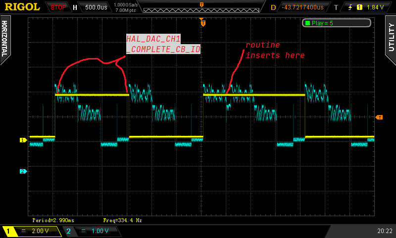

The stream consistently repeats until the swap_buffer function executes. This glitches the DAC pulse.
When observing the DAC output under an oscilloscope. the function seems to cut off a pending DMA cycle
Current result...
Intended result: Another Edit: (to remove the delay I placed the swap routine into the callback.. This presents other problems. Chiefly the main routine could request 2 swaps whilst the DMA is being

Which STM32? There are multiple generation of DMAs.... in cyclic mode, DMA usually doesn't generate interrupts. It can help to know more the intended expected result rather than describing the tried scenarii....
‎2022-12-05 11:08 AM
Yeah sorry I tried to keep it brief. It's the STM32H7B0 or any STM32H7A/B. I'll edit my post
‎2022-12-05 11:44 AM
>My intention is to swap a DMA buffer ...
just - could you say, what you wanna do , what is the target, what you want to achieve overall?
‎2022-12-05 6:33 PM
Your need seems to be similar to the old cd player, how to avoid glsound glitch if the player is bumped. Most DMA can split the pointed memory data block in 2 parts. It is sometime called half transfer interrupt. Basically while the dma sweep through one half, you update the other one that is not, and swap at half xor full transfer interrupts.
‎2022-12-05 7:04 PM
Thanks for the advice. Unfortunately the buffer size is variable and to complicate matters further the buffer cycles. If I were to introduce half the buffer into the last cycle I would still need to stop and start the DAC/DMA to change the buffer length...:(
I do admit though that the glitching is now probably purely down to this resetting of the DAC/DMA. It's pretty quick and barely noticeable for my needs (it a visual application and persistence of vision and our eyes slow refresh rates make it almost ideal so far...). I think the biggest problem is the delay waiting for the last cycle to end so that the buffer can be swapped...
I think I've improved it a tad by putting the swap routine into the Callback and setting a swap flag in the main routine that notifies the Callback to swap the buffer...

You can't change the length of the DMA buffer without disabling and re-enabling the DMA. Doing so will have the possibility of missing values as you cannot respond instantly to the DMA completion event. You can get close, maybe a few us, but not instant.
One way of driving the DAC with varying inputs is to generate them on the fly in a circular buffer or with interrupts, although this will not be computationally feasible at the highest DAC update rates.
‎2022-12-06 9:49 PM
