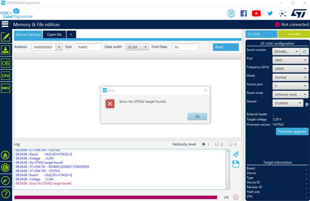

How to solve the problem with:
1. " Error: No STM32 target found!".

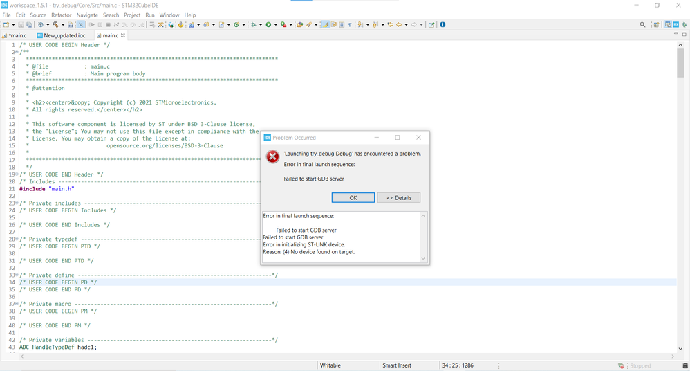

2. "Error in final launch sequence:
Failed to start GDB server
Error in initializing ST-LINK device.
Reason: (4) No device found on target."
‎2021-07-25 8:44 PM
--The first error encounters while trying to connect the board (STM32H7A3ZI-Q) with STM32Cube Programmer at normal mode.
--The second error encounters while trying to upload a code through STM32Cube IDE.

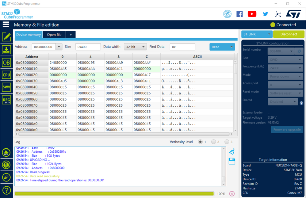

However, when I try to connect the board with STM32Cube Programmer at power down mode, it successfully connect .
Hence, being a naïve in this area, I hope everyone helps me out to find the solutions. Thank you.

‎2021-07-29 8:27 AM
I had the similar problem with H725 MCU which maybe the same root cause. If new STLink fw doesn't fix it, check these:
- make sure selection of power supply scheme in your code matches with your Nucleo-H7A3. If not, correct the selection
- After correcting selection of power supply scheme, you may have to do "erase chip" since the MCU was already programmed with wrong ps sheme
- follow this link to "erase chip" and other possible fixes https://community.st.com/s/article/FAQ-Unable-to-connect-to-STM32H7-devices
good luck

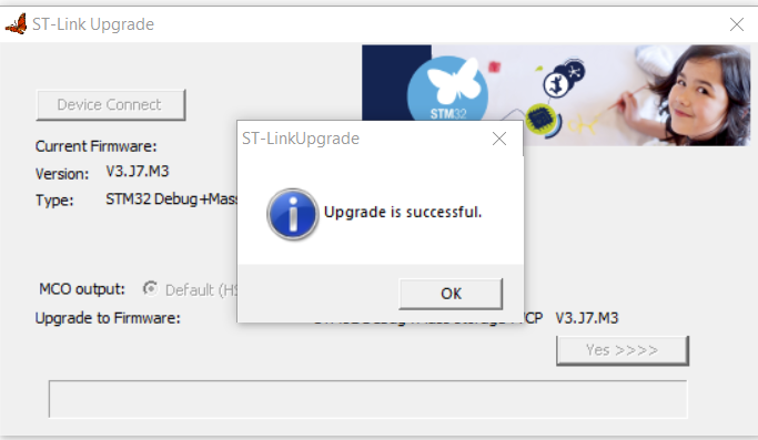

‎2021-07-29 8:00 AM
Hello @PWaiba​ and welcome to the Community,
Your STLink firmware version is an old version.
So, please try to upgrate your STLink firmware. Then keep me informed about your update.

‎2021-07-29 8:32 PM
Although the upgrade is successful, the error still encounters while uploading the code as cited in the picture.
‎2021-07-29 8:58 PM
I followed the link and found that the issue was with my power configuration. By following the steps there, my issue is solved. Thank you @Community member​ .
