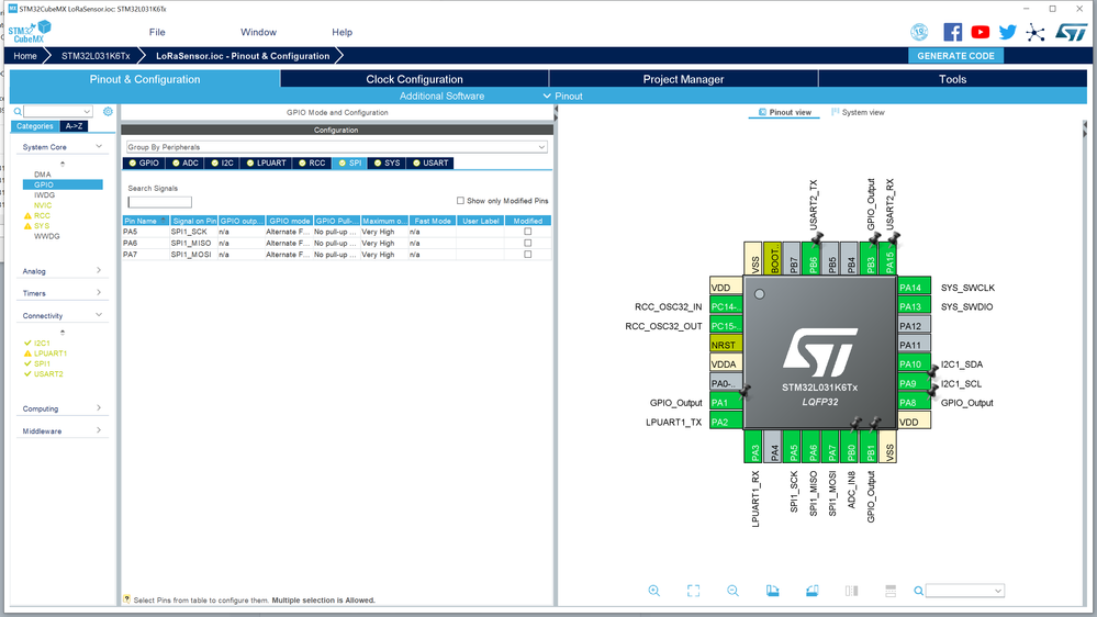

I am a newbee to STM32 development and I am struck with not being able to communicate with flash at all.

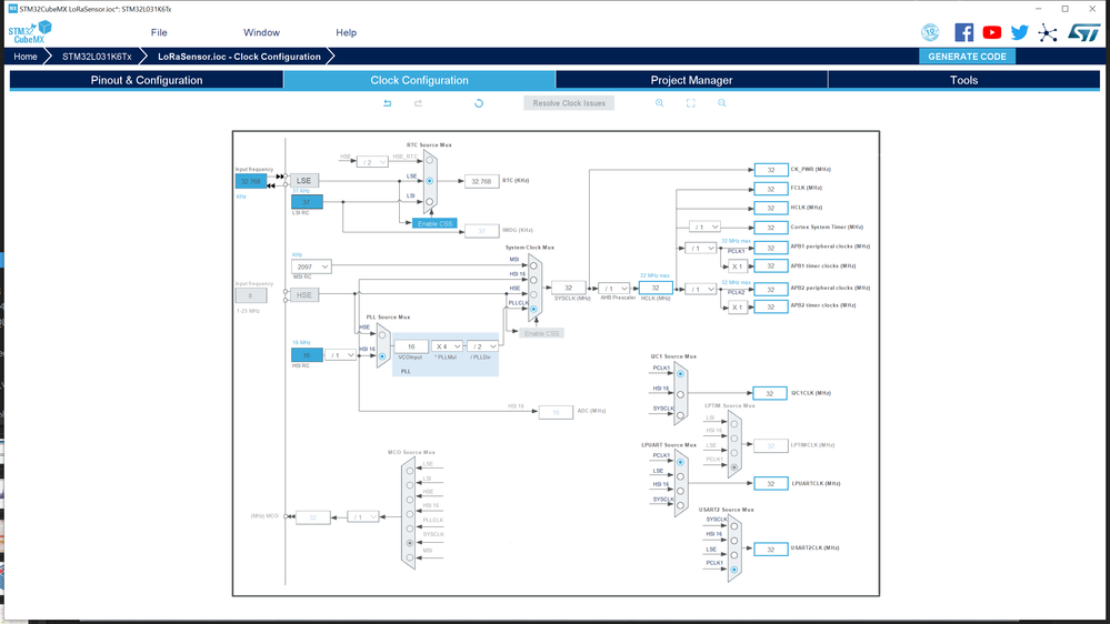

  RCC_ClkInitStruct.AHBCLKDivider = RCC_SYSCLK_DIV16;
  RCC_ClkInitStruct.APB1CLKDivider = RCC_HCLK_DIV1;
  RCC_ClkInitStruct.APB2CLKDivider = RCC_HCLK_DIV1;
  if (HAL_RCC_ClockConfig(&RCC_ClkInitStruct, FLASH_LATENCY_0) != HAL_OK)
    Error_Handler();

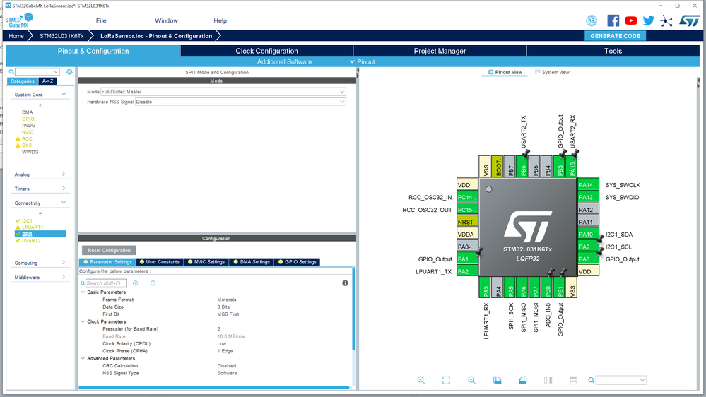

static void MX_SPI1_Init(void)
  /* USER CODE BEGIN SPI1_Init 0 */
  /* USER CODE END SPI1_Init 0 */
  /* USER CODE BEGIN SPI1_Init 1 */
  /* USER CODE END SPI1_Init 1 */
  /* SPI1 parameter configuration*/
  hspi1.Instance = SPI1;
  hspi1.Init.Mode = SPI_MODE_MASTER;
  hspi1.Init.Direction = SPI_DIRECTION_2LINES;
  hspi1.Init.DataSize = SPI_DATASIZE_8BIT;
  hspi1.Init.CLKPolarity = SPI_POLARITY_LOW;
  hspi1.Init.CLKPhase = SPI_PHASE_1EDGE;
  hspi1.Init.NSS = SPI_NSS_SOFT;
  hspi1.Init.BaudRatePrescaler = SPI_BAUDRATEPRESCALER_2;
  hspi1.Init.FirstBit = SPI_FIRSTBIT_MSB;
  hspi1.Init.TIMode = SPI_TIMODE_DISABLE;
  hspi1.Init.CRCCalculation = SPI_CRCCALCULATION_DISABLE;
  hspi1.Init.CRCPolynomial = 7;
  if (HAL_SPI_Init(&hspi1) != HAL_OK)
    Error_Handler();
  /* USER CODE BEGIN SPI1_Init 2 */
  /* USER CODE END SPI1_Init 2 */

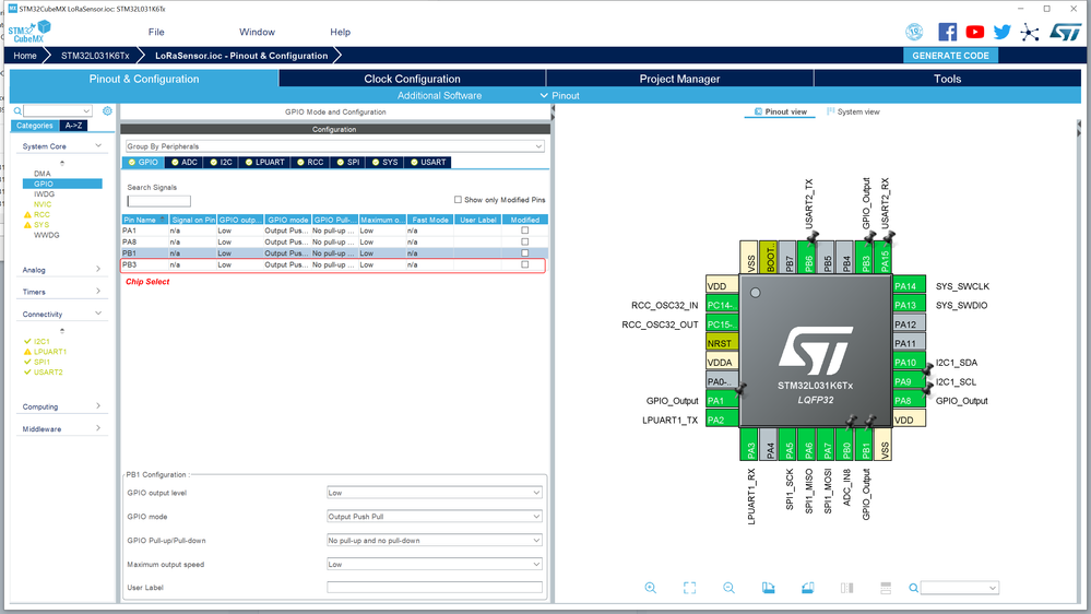

  HAL_GPIO_WritePin(GPIOA, GPIO_PIN_1|GPIO_PIN_8, GPIO_PIN_RESET);
  HAL_GPIO_WritePin(GPIOB, GPIO_PIN_1|GPIO_PIN_3, GPIO_PIN_RESET);
  /*Configure GPIO pins : PA1 PA8 */
  GPIO_InitStruct.Pin = GPIO_PIN_1|GPIO_PIN_8;
  HAL_GPIO_Init(GPIOA, &GPIO_InitStruct);
  /*Configure GPIO pins : PB1 PB3 */
  GPIO_InitStruct.Pin = GPIO_PIN_1|GPIO_PIN_3;
  HAL_GPIO_Init(GPIOB, &GPIO_InitStruct);

I would appreciate if someone can point out where I am going wrong.

Missing actual code that sends SPI data, and function that's failing.
Check signalling with scope or logic analyzer. Check chip select.
Start be reading JEDEC ID from chip.
