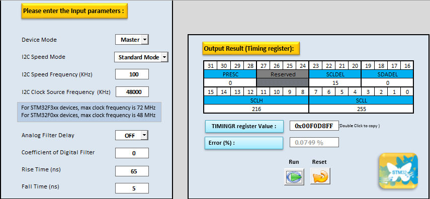

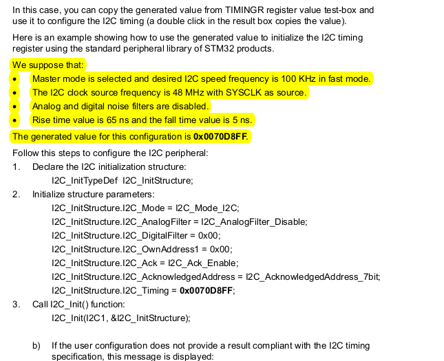

I try to write the driver for I2C and I open the reference I face a problem in setting values for SCLDEL SDADEL SCLH SCLL and I don't know how to set theses values. I kept searching and I saw there is an Excel sheet you can enter the Pclk and I2C speed frequent,rise time ,fall time, and choose filters then you will get the value I try to apply the example which is provided in the below picture but the result is not the same as the photo
So to summarize What do I need to help me in it?
Why the result is different?
How to set values of ( SCLDEL SDADEL SCLH SCLL )? It will be great if you give a formula to understand instead of reference which I can't understand it.
