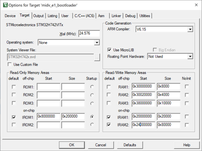

I'm having weird problems with code crashing, perhaps related to how I have IRAM1/IRAM2 set up in my project:

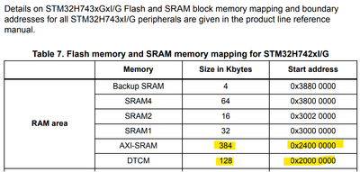

Looking in the reference manual, I see that the SRAM starting at 0x2000_0000 is the DTCM_RAM on TCM interface (data RAM?), the SRAM starting at 0x2400_0000 is the D1 domain, AXI SRAM but I don't see any documentation for how big either of these are.  I also can't figure out what is meant in Keil by IRAM1 vs. IRAM2 (Google is not very helpful), although I suspect that question might not be within the scope of the STM forums...

I edited the stack size in startup_stm32h742xx.s.  It used to be 0x400 and I changed it thus:
Stack_Size		EQU     0x800
Problem solved!
I'm still not sure why this project needs a bigger stack than an equivalent project on an STM32F3* MCU, but I'll take it!

Memory sizes are in the datasheet and reference manual.
You have AXI SRAM set to 0x80000 but its size is only 0x60000. Could be the issue, could be issues with the code itself.
IRAM = internal RAM. This is Keil terminology.
Ok wait a minute — isn’t 384kB actually 0x6000 and not 0x60000?
EDIT:  Sorry, I was getting 0000 confused with 000!
No, that's 24KB
0x20000 is 128KB
0x40000 is 256KB
0x80000 is 512KB
