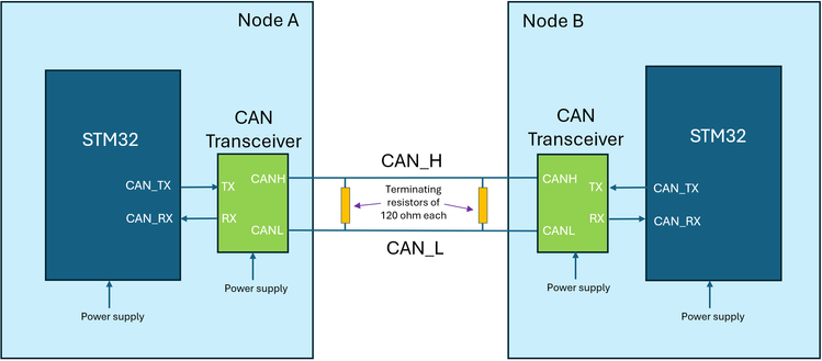

For Normal mode you need to establish a complete CAN bus where you are using a transceiver to connect the MCU to the bus and at at least another CAN node that should see your node on that bus to acknowledge the frames sent from your CAN node. This is the minimum hardware requirement to establish a CAN bus:
CAN is not UART or SPI to monitor the traffic in "open bus" mode.
