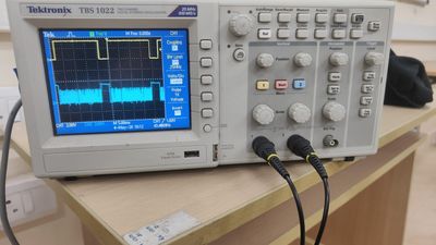

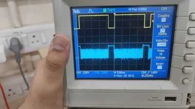

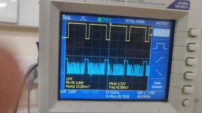

dinesh_ee_bme_72
Oscilloscope Capture — BNO085 + STM32H7A3, I2C1 @ 1 MHz
Scope: Tektronix TBS1022 | Date: 4-May-26 16:12
Channel settings:
  • CH1 (yellow): 2.00 V/div
  • CH2 (cyan): 2.00 V/div
  • Timebase: 5.00 ms/div (50 ms total window)
  • Trigger: CH1 rising edge @ 1.60 V
  • Scope-measured frequency: 43.25 – 43.46 Hz
What is visible on CH1 (yellow trace):
The yellow trace sits at a steady HIGH level for most of the window. It then drops sharply to LOW for a short duration, then returns to HIGH. This pattern repeats twice within the 50 ms window. The scope's auto-frequency measurement reads the period of this repeating HIGH-LOW-HIGH cycle as approximately 43.4 Hz.
What is visible on CH2 (cyan trace):
The cyan trace shows alternating regions. In some regions it is flat and quiet, sitting at a steady level. In other regions it becomes a dense, rapidly oscillating hash — this is the I2C clock toggling at 1 MHz, which is too fast to resolve individually at the 5 ms/div timebase so it appears as a filled block of activity. Within the 50 ms window, there are multiple such active blocks separated by quiet flat sections.
Spatial relationship between CH1 and CH2:
The transitions on the yellow trace (CH1) and the active hash blocks on the cyan trace (CH2) occur in the same regions of the time window. The quiet flat sections on CH2 correspond to the periods where CH1 is sitting steadily HIGH.

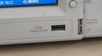

Your scope has a USB socket for a Flash Drive on the front:
You will be able to capture screenshots to this.
This will give much better results than photographs!
