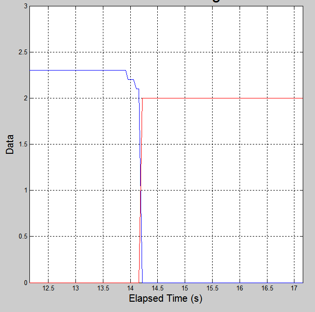

Hello all, i am trying to do a simple pid simulation with discovery board and matlab.
However i dont think that my data is runing as it should, what i want to say is that i dont get the usualy rising spike edge from the pid. The pid calculation is done in the microcontroler, matlab only reads the two serial datas separated by @ character.int main(void){

This is my pid plot.
blue line - is adc read from pot ( when potentiometer is idle it measures about 2.3 volts)
red line - is the pid output

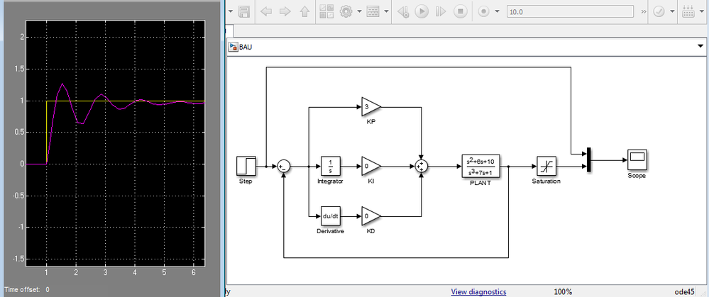

And here is a simulation graph done only in matlab environment wich shows me very nicely the glitch of pid response at the rising edge
