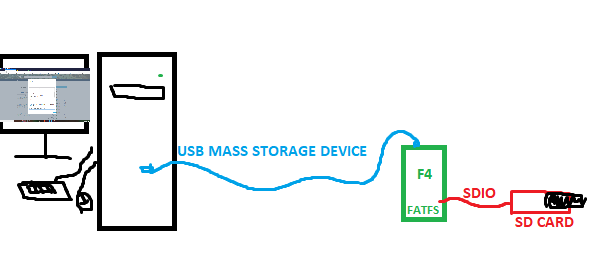

Howdy, im very new with filesystems and SD cards in general.
I am trying to develop a system that can manage files from a SD card (images ) and also interface between the PC and the SD card trough USB.

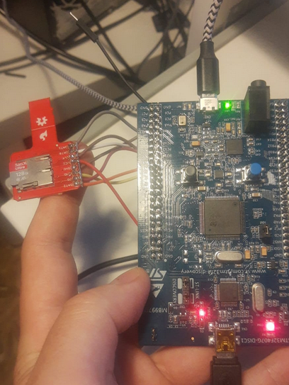

I managed to get my stm32f4-discovery working with an USB mass storage device and a SD card conected via SDIO.
It works but my stm32f4 blindly writes and reads the sd card when USB mass storage asks for it.
I want my stm32f4 to be able to search folders and read/write files from the SD card also ,so i am trying (unsuccesfully) to add the FATFS middleware.
I find tutorials about USB+SD card and FATFS+SD card but not all of them together.
Am i trying to do something weird here?

So... my issue was not declaring the SIO detection pin in cubeMX
https://community.st.com/s/question/0D53W00000mlP0wSAE/detectsdio-in-cubemx-no-solution
Now it works (sometimes)
