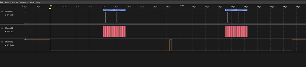

I need to transfer a large amount of bits over SPI de-asserting/asserting the select line very 64 bits. I'm using DMA. The time between transmissions is huge, as can be seen below:
0693W00000aHFGqQAO.pngThe pink channel is SCK, each chunk is 64 bits. The code is below:
while (1)
 /* USER CODE END WHILE */
 /* USER CODE BEGIN 3 */
 HAL_GPIO_WritePin(GPIOA, GPIO_PIN_4, 0);
 HAL_StatusTypeDef rc = HAL_SPI_Transmit_DMA(&hspi1, buff, 8);
 while (LL_SPI_IsActiveFlag_EOT(SPI1)) {}
 HAL_GPIO_WritePin(GPIOA, GPIO_PIN_4, 1);
 HAL_Delay (1000); /* Insert delay 100 ms */
How can I decrease this delay?
I have though that I could config. DMA to send all the data I have, but I need to generate a pulse in the SPI SS line every 64 bits. How can I do this?

waclawek.jan
February 20, 2023
Don't use Cube/HAL.
Increase optimization level of compiler.
You could generate complex waveform of SCK/NSS using timers in master-slave arrangement, and feed them back to SPI used as slave.
S.Ma
Principal
February 20, 2023
If sending 2 blocks of data bidirectionally, use TXE, and "RXNE" at the end of all data transfer.
DMA setup takes time in HAL... you already use LL for GPIO, use HAL for GPIO and compare them.
Some STM32 have HW 32 bit FIFO on SPI, some other STM32 have linked list DMA which could make intra data packet delay down to nearly zero remains the time from NSS down to SCK toggles, and SCK stop to NSS up delays.
