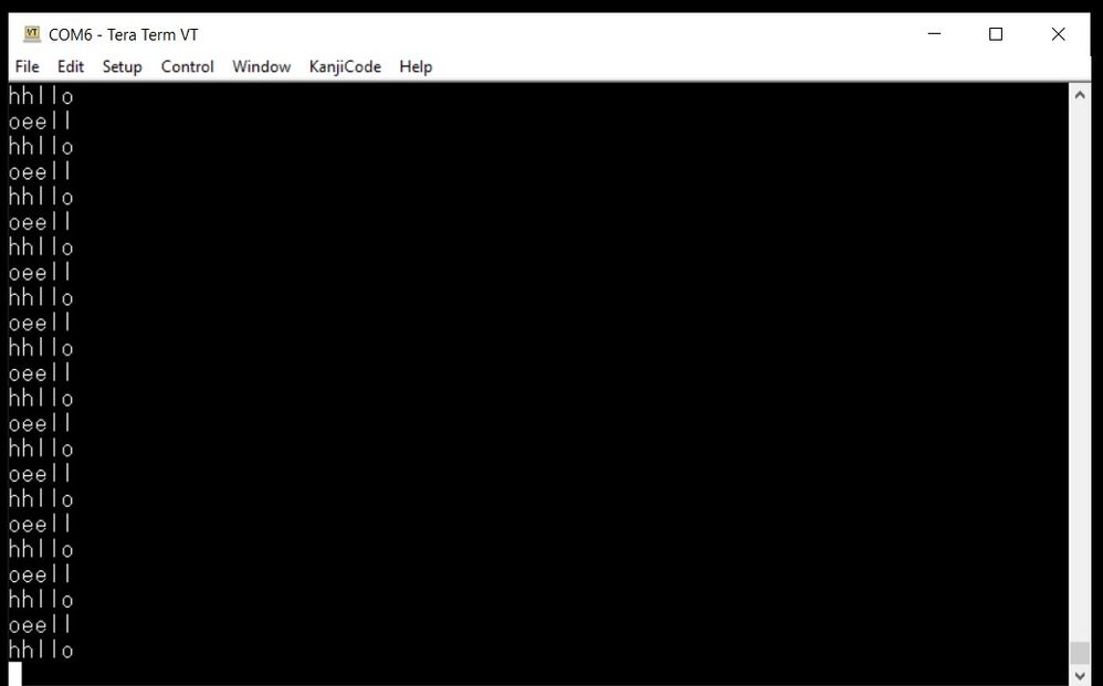

I am learning serial protocols using STM32 boards (F411RE and L432KC). So far I have successfully configured the boards as master and slave to send data from one board to another, and as I checked it works perfectly(I communicate the received data from board to PC via UART). That utilized the MOSI line. Now I am trying to get data from the slave, using the MISO line.
As I learned, to get data from slave you write a dummy byte to slave like 0x00 and get the data in the same chip select cycle. I did that and hooked up the MISO line to scope, decoded it and the line has my string in the appropriate order.
However, storing the string on the master side seems to be an issue. Both the MCUs have a single data register in SPI module for tx and rx.
I try to send "hello" from slave and this is what I am getting on master:
It's not perfect, there are repeated as well as alternate characters.
I am sharing the codes for master and slave, which are quite long, but the main function might be the only thing to looked at.

I have tried removing the given delays too, had no effect.
Since on the scope, I am getting the data on MISO line correctly, I suspect my method of storing data on master side is the flawed one.
How do I deal with this?
waclawek.jan
buff[i] = *(__IO uint8_t *)&SPI1->DR; //store MISO data in buff
See Data packing section in SPI chapter in RM. You have used it for Tx...
2 REPLIES 2
waclawek.jan
Thank you so much. You pointed reading Data packing last time too, but I didn't, sorry. And as you pointed, yeah I forgot the casting. My bad. :grinning_face_with_sweat:
