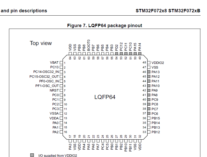

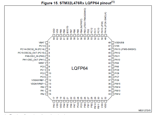

I am having a code for the target device stm32l476rg and now i need to port the code to stm32f072. Is it possible to migrate. if yes how is it possible . I saw both are pin to pin compatible so no need of hardware changes.

Hi Berendi,
Hereby attaching the pinouts of both L476 and F072. STM32F072 is having less peripherals than the L476 IC. I want to use the peripherals which is there in stm32f072. I want t0 migrate the code written for the L476 to F072.
berendi
Principal
These figures don't cover the possible alternate functions.
The first step is to check the GPIO alternate function settings of your application on the L4, and find out whether the same peripheral functions are available on the F0 on the same pins.
