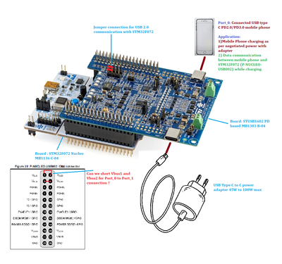

I am new to firmware development and using the P-NUCLEO-USB002 USB type C board for pass-through charging.
I have identified the few hardware settings for the pass-through charging and data communication between USB type C Port_0 and Port_1.
- connected mobile phone to Port_0
- connected PD charger to Port_1
- Power Connector CN4 Pins shorting done for Vbus1 and Vbus2 connection
- Removed the jumper connection of JP401 and JP400
Please suggest for below queries.
1) Can we use this pass-through for mobile charging between Port_0 and Port_1?
2) Is there any demo firmware for the Pass-through charging between Port_0 and Port_1?
3) How to check the status of the PD connection or messages using UART/I2C? ( default firmware received with kit were modified with STSW_STUSB010_v1.3 example codes, But unable to get PD messages on UART. if STSW_STUSB010_v1.3 example codes do not support the UART/I2C debug then please provide the default firmware of the P-NUCLEO-USB002).
4) Can we control and make the decision based on PD messages of SPI/I2C communication between STUSB1602 and STM32F072 controller to control the GPIOs?
please find the attachment.
Please suggest.
Thanks & Regards
Shashikumar Rai

As per the picture shared, port0 has source role and port1 has sink role.
You need to refer to schematic for power connection: seems that CN4 pinout you pointed out is not in line with schematic. To fit with your example, I do suggest to
* remove JP401 and JP400
* connect JP001and JP00 to position 1-2 (they are already correct on your picture)
* Then I suggest to connect CN12 (Vbus of port 1) to powconn1/3 of CN4 (pins 1 & 3) which will be the 'input supply' for port0 acting as a source.
