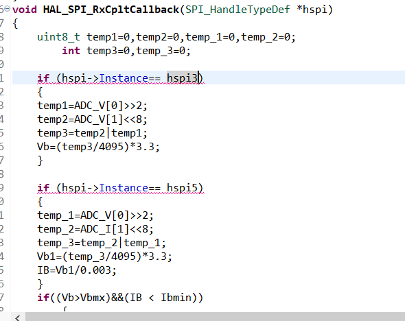

I am working on stm32h745. I have to use 3 spi in interrupt mode, then how I can know which spi is get interrupted?

If you're using HAL, the function will pass a handle. Check the handle instance with the relevant SPI peripheral.
if (hspi->Instance == SPI1) {
} else if (hspi->Instance == SPI2) {

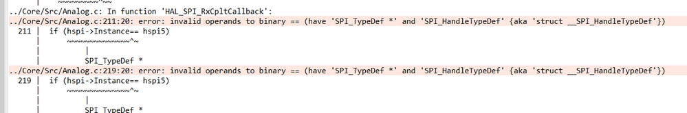

This error is getting
‎2022-04-29 11:09 AM
Okay, well you didn't write what I wrote, so the error is expected.
Either compare the instance or the handle. Don't compare the instance against the handle. The error message is descriptive of the problem.

‎2022-04-29 11:20 AM
Match the right things.. with equivalent TYPES
hspi == &hspi3
Preferred is
hsip->Instance == SPI3
The address of the PERIPHERAL instance, not the handle/pointer to the structure pointer
‎2022-04-29 1:01 PM
Compare against SPI3 instead of hspi3.

TDK wrote an exact example, but the person is not even capable of doing a copy-paste...
And the code inside is just totally broken. Shifting something left by 8 bits and then assigning to 8-bit variable will always result in zero. All of those shifts seem to be trying to do what a simple casting can do. The ADC range is 4096 values, not 4095. And then dividing an integer with an ADC range also as an integer, will again result in a zero.
