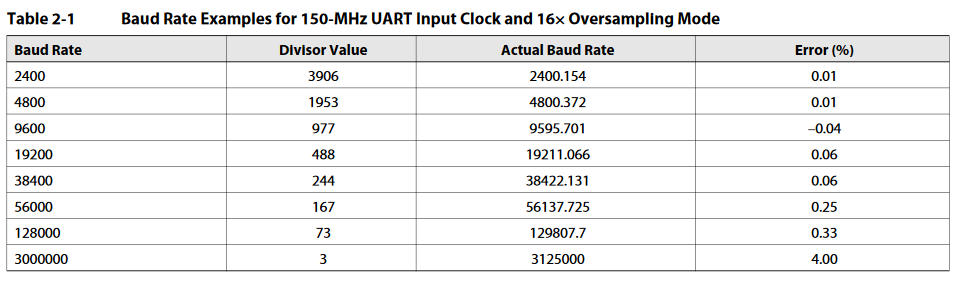

How should a UART interface be designed so that a robust communication possible can be established between two MCUs. The following table is shown in a data sheet from Texas Instruments. You can see the error rate depending on the baud rate.
0693W000007DYU5QAO.pngAccording to my research a low baud rate below 57600 bit/s and 16x oversampling is suitable for a communication over a longer distance.

As mentioned previously that table you posted is for baud rate error%, not for data bit errors.

The error in this table is the deviation from the target baud rate. The baud rate must be derived from a clock, which is 150MHz in the example, which in turn is probably generated from an external crystal using a PLL. If you calculate the error in the table yourself by using e.g. the values for the row 56000:
(150MHz/(16*Divisor*TargetBaudRate))-1
you will get the value 0.002459..., which you have to multiply by 100 to get the percentage value 0.25 (rounded).
