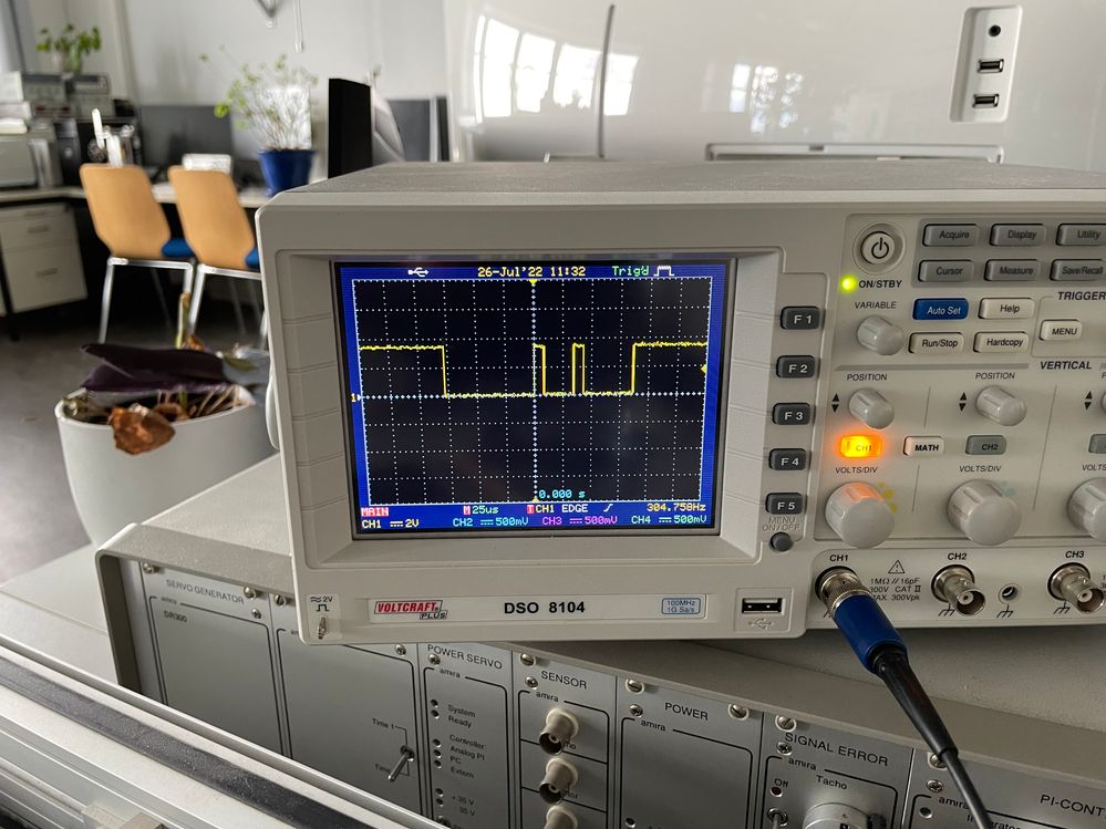

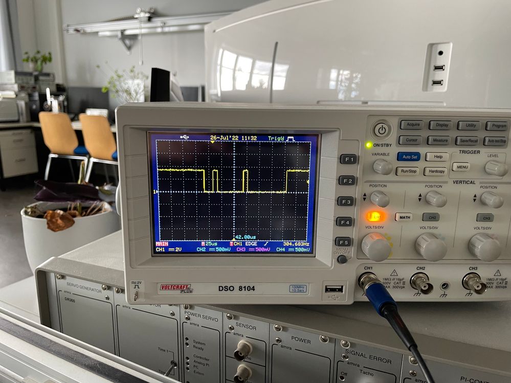

Okay let me show the picture of the scope. Because I am fairly new to UART.
When I send the number 2 as bytes through UART in Simulink:
When I send the number 1024 as bytes through UART in Simulink:

Your oscilloscope can save the screen image to a USB stick:
https://www.manualslib.com/manual/1595629/Voltcraft-Dso-Four-Channel-Series.html?page=64#manual
This will give far better, clearer results than a photograph!

"When I send the number 2 as bytes through UART in Simulink"
Do you know what Simulink actually sends when you do that?
- The binary value 2 ?
- The character 2 ?
- Does it add any padding ?
- Does it add CR and/or LF ?
- etc, etc, ... ?
What does a simple terminal show?
Again, Simulink may be giving more confusion than help.

"Do you know what Simulink actually sends when you do that?"
So the input value is set as a uint16, and then with the Byte Pack block in Simulink, it packs the input data into a single output vector type uint8. There are no indications of whether it adds padding or CR/LF.
