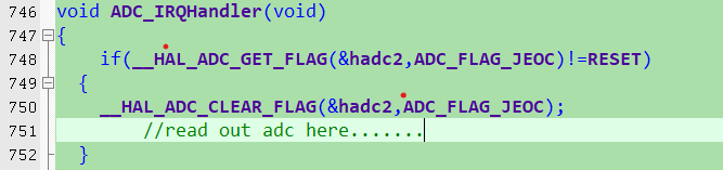

this is ADC interrupt handler:
this ADC interrupt hits Line 750 three times during one TIMER1 period, however, I just want one hit at LINE 750 after ADC sampling which triggered by T1 CC4​ event.
