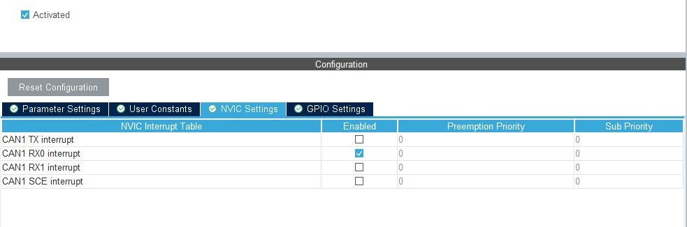

Hi! Make sure you doing the following:
  • Unmask the appropriate CAN interrupt in the cortex-M NVIC
  • Enable the appropriate CAN interrupt in the CAN register block (maybe CAN_CR?)
  • Set up an interrupt handler funtion for this CAN interrupt, where you clear the interrupt flat (maybe CAN_ICR)

I m using cubeMax for pin configuration and atollic trueStudio for development.
It is entering in sleep mode successfully but not coming out from sleep mode when next expected CAN data is received. as shown in above code.
