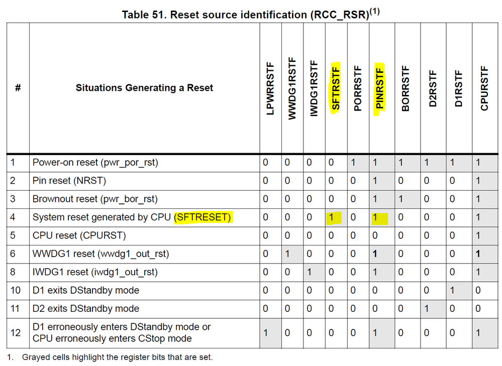

Why pinrst is configured after sftrst
ckim.2390
If you run it with the reset pin, you can use the "__HAL_RCC_GET_FLAG()" function
You can see that "RCC_FLAG_PINRST" is set.
However, when executed with "HAL_NVIC_SystemReset()", "RCC_FLAG_SFTRST" and "RCC_FLAG_PINRST" are set.
My expectation is that only "RCC_FLAG_SFTRST" should be set.
what is the reason?
And "__HAL_RCC_GET_FLAG(RCC_FLAG_LPWRRST)" doesn't work at all.

That's just how it works. PINRSTF is set on most types of reset. Examine all flags and match up to the expected pattern for the given reset type.
thank you. Resolved.
What kind of document is the screenshot?
That’s in the stm32h7 reference manual.
