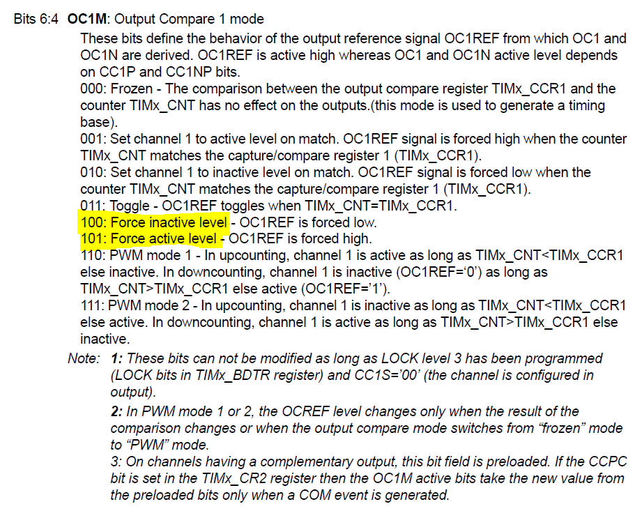

If you set a timer in Output Compare in Mode "Toggle" and assing a Chanel to a pin of your uC you can make it toggle when CCRx == CNT. That works just fine, as expected.
My question is: when you configure the Mode of that Channel to “Active on Match�?, how can you clear that pin to low again? It keeps allways Active. To clear the pin I tried:
HAL_GPIO_WritePin(GPIOB, GPIO_PIN_1, 0) inside the callback void HAL_TIM_OC_DelayElapsedCallback , and also in the main(), but it does not work. Is there any way?
The same aplies for the mode “Inactive Level on Match�?.
Thanks a lot guys,
Guru
You need to modify the TIMx->CCMRx_OCxM bits to what you want. The pin cannot be controlled directly.
You probably want to use the "force active/inactive level" options.
You could also reinitialize the pin as GPIO and control it that way.

For example, setting CH1 on TIM2 to Force inactive:
TIM2->CCMR1 = (TIM2->CCMR1 & ~TIM_CCMR1_OC1M) | (4 << TIM_CCMR1_OC1M_Pos);
Hey, thanks for your answer JW! That *kinda* works.
But than it's LOW forever. I would like to set it to LOW, so next time it matches TIM2->CNT it becomes active again. "Force inactive" disables the "Active on match". I don't know how I can achieve this. Is there some trigger I have to reset? I did already read through the docs about timer, but I don't know what to look for exactly.
Well, then after you set it to Force inactive, set it again to Active on match.
What's the problem with that?
