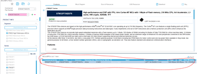

I am trying to find a processor for the product that I am working on with larger RAM and FLASH but it must remain pin compatible to minimise code changes. The current processor is this "STM32F756ZGT6". With the current application its RAM is throttling at 100% and more features are still pending to be added. Therefore, if I can find another processor with the same pinout then the problem will be resolved.
Any help would be appreciated please?

->just guessing : stm32H743ZI (most pins compatible) , 1MB ram, 2MB flash.

if you click pinout in Cube , then can select : list pin compatible... try:
‎2024-05-23 10:52 AM
Dear AScha,
In my case it only gives me one processor. Many thanks for your reply though.

What other Series did you check box?
The 144-pin devices have the broadest pin compatibility, unless you are using a function/peripheral that doesn't map exactly.
For that F7 die I don't think there's a more RAM/FLASH option within the family.
I'd expect there's an H743 which would fit

I was trying some others and found this one which seems to have the same pinout but 2M Flash and 512KB RAM.
Is this a good swap do you think?

You have provided an excellent suggestion. I will look into this further. 1M RAM is absolutely charming,
