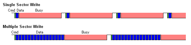

The root cause of the slow write speed is single-sector writes to the SDcard and busy waiting until they are completed.
The FATfs docs show this useful graphic that illustrates the problem.
However, the PC asks to write in larger blocks. The USB code in HAL supports multi-packet requests, but the usbd_msc code does not use that ability. The bulk only transport (BOT) buffer is defined as a single packet, and when the PC asks to send more data, the code ignores it and only handles a single sector.
