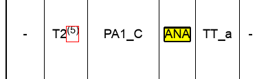

We are using STM32H743IIK6 microcontroller. There are analog only pins, designated as ANA. What is the use of these pins? Also, what will be the difference when GPIO is used for analog functionality and ANA pins are used for the same purpose?

AScha.3
You mean this :

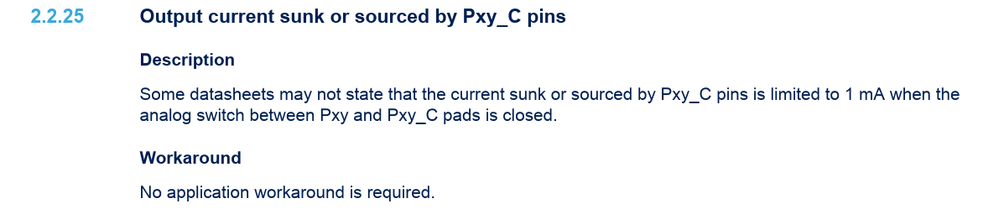

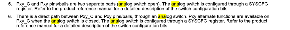

AND then from chip errata :
So you can use them, as you like , just be aware : these pins are connected by a small analog switch and will not survive > 1 mA in or out current. (And i know...i tested it and can confirm: then pin function is gone...)
