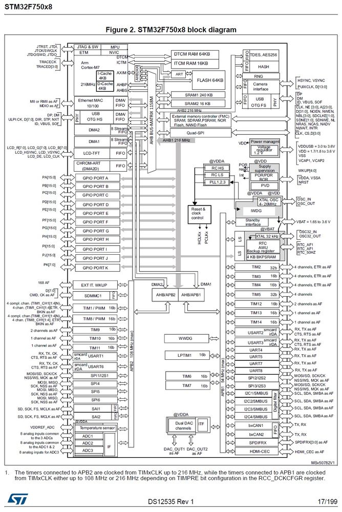

I am generating a PWM frequency with Timer5 in a STM32F7 device and I noticed that the TIMER5 input clock is 1/4 of HCLK by default and it is connected to APB1. I was checking in the documentation or in the code how to connect the input clock to APB1 multiplied by two or if it is possible to connect to APB2.
Where is indicated the APBx of a certain TIMx and how to select the APBx freq or APBx freq x 2?

The Reference Manual and clock tree diagrams?
The TIMCLK is always APB x2 except in the case where APB is DIV1 wrt AHB, as it doesn't actually multiply, it just pulls a clock feed one divider earlier in the chain.
A TIM uses APB1 or APB2 depending on how resources were allocated to peripherals in the design, it is fixed.
Where are such resources allocated? Can I check that with CubeMX?
Depends on what APB1 is set too, most systems it is usually DIV2 or DIV4, as APB2 is the faster bus
The system block diagram from the data sheet might be what you need to review.
ihouses ihouses
I see thanks. I am not familiar with STM32 architecture so I not even thought looking at the main diagram, I am coming from the PIC world :)
Now only remains to know how to select between ATBx and ATBx x 2, any idea?
You don't really get much of a choice, it is primarily driven by the APB divisor, and you get to further divide with the prescaler.
