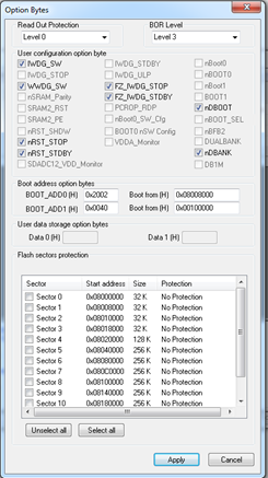

The default values of the option bytes are:
With the default values in the option byte the program dosen?t work.

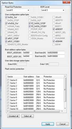

I tried change it for pointing to the 0x08008000 (flash second sector star address):
But with these values still not working.

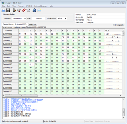

Although my program should be in the 0x08008000 address if I read the 0x08000000 there are some code:

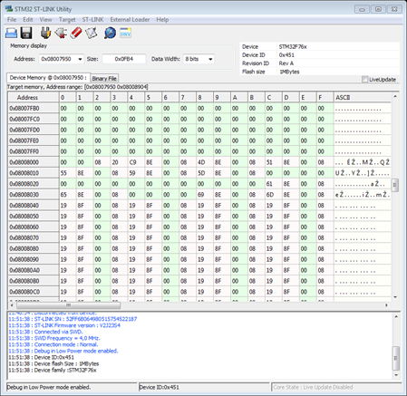

If I read the 0x08008000 seems that the program is stored in this area.
I don?t understand why the first section (0x08000000) isn?t emty.

Beside that it looks like you have flashed the elf file right to the default start address (see the ELF pattern at address 0x08000000). You should create a hex or binary file out of the elf and flash this instead of the elf file.
