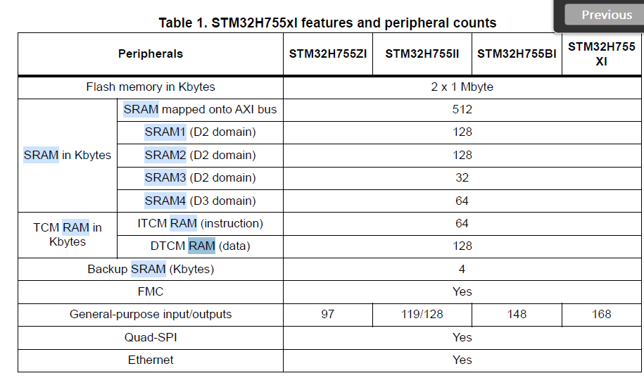

another thing I am considering is that the RAM blocks are as follows:
based on Linker script file I mentioned before, a 256KB block is only used . that is the reason of RAM overflow ,I think... .
2) How Can I use a bigger block? for example the block the name of which is SRAM mapped onto AXI bus 512 in the table below?
Despite the searches I did I could not understand how to change the linker-script files. Is there anybody who has time to help me regarding the mentioned two questions??
I think the more logical choice is to just select the bigger RAM In D1 domain which is also provided to M7 Core I am using ....

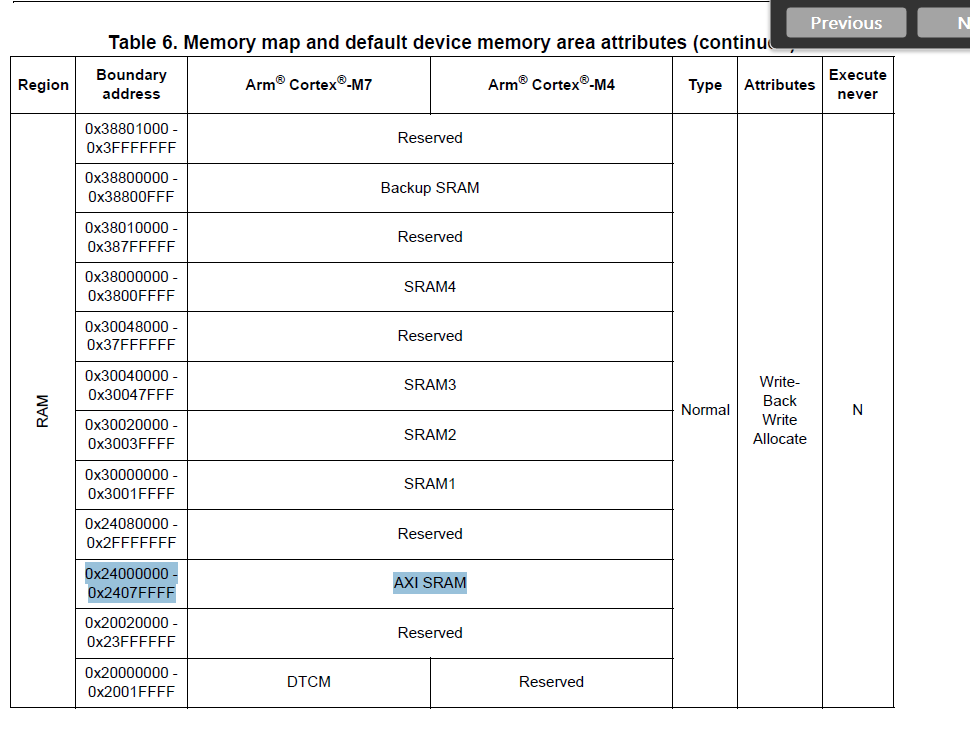

I tried changing the address space of the ram in the .ld file . at first, it was from /* : ORIGIN = 0x24000000, LENGTH = 256K */ to /* : ORIGIN = 0x24040000, LENGTH = 256K */.
then I changed it from 0x24000000, LENGTH = 512K to : ORIGIN = 0x2407FFFF, LENGTH = 512K according to memory-map file in the user manuals but after biulding the project I still get the ram overflow messege...... Please Help :)))
here are the error messeges.

‎2021-01-06 10:00 AM
Ok, but why is the code there?
The AXI RAM is 512KB, the SRAM1,2,3 are contiguous with another 512KB, and there's 128KB in the DTCM

I want to put the variables near 45000 samples in RAM each hour, I collect 45000 sample, then I send them to a WIFI module then I clear the RAM and the next hour I will do the same iteratively.
I did step by step as it was mentioned in this page:
https://www.openstm32.org/Using+CCM+Memory?structure=Documentation
I aslo copied the linker script file you sent in my project and define my variable as you told kile this: __attribute__((section(".ccmram-strings"))) float Data_Set_Z[15000]; but I got the ram overflow messages like before.
moreover than Data_Set_Z[15000], I also defined :
float Data_Set_X[15000];
float Data_Set_Y[15000];
but these two array occupy more than 90 percent of my RAM so I can not add the third array which is Data_Set_Z[15000] to store my whole dataset.....
As my last hope :))) I was wondering whether it would be possible to change the dedicated memory area. Based on linker script file, memory is divided into two parts:
/* Specify the memory areas */
MEMORY
RAM_EXEC (rx) : ORIGIN = 0x24000000, LENGTH = 256K
RAM (xrw) : ORIGIN = 0x24040000, LENGTH = 256K
1- would it be possible to dedicate more area to the part my arrays are inside ?? and make the rest smaller?
You keep restating this like it answers the question, but WHY does the CODE need to be in the RAM too? I understand you want to store the DATA in RAM.
You're picking these memory areas and sizes, there's other memory you can use, and you can pick how this is balanced/distributed.
You tell the linker what your desired floor plan is. It can only use memory you tell it about.
If you make it more complicated in the GNU/GCC implementation you're going to have to add code to startup.s to copy/initialize different areas.
To see what the linker has done you'd review the .MAP file
