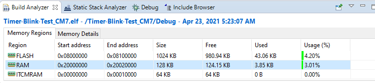

My first problem is that after storing around 12000 samples, without changing the linker-script file, my program crashed.... when I store only 30000 samples, the program works correctly...
1- What can be the reason?
I checked the address of the DTCMRAM which starts from 0x20000000 (in your answer it was 0x00000000). now after I changed it, the performance of the program gets even worse and after storing 3640 samples into RAM the program stopped working.... it crashed.... Can you please inform me what I am supposed to do ?...
0693W00000AMJ8rQAH.pngAnother thing that seems strange to me is that the build analyzer shows the ram amount for 128KB . The M7 core I am using access directly to AXI SRAM the size of which is 512KB. maybe if I find a way to increase the memory which is shown in build analyzer, that can solve my problem without using DTCM RAM... What do you think in this regard?
About changing the statup.s file, maybe that is too much to be asked.... can you also help me in this regard?
