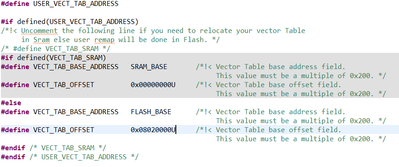

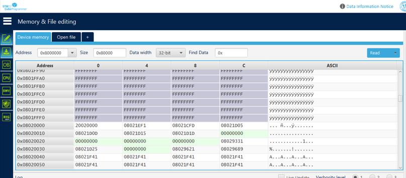

I'm using a Nucleo-F446RE board and have successfully flashed my application code to Sector 5 of the internal flash memory. The code runs correctly right after flashing, but it does not run after a reset or power cycle.
It seems the MCU still boots from the default start address (Sector 0), and doesn't automatically jump to Sector 5.

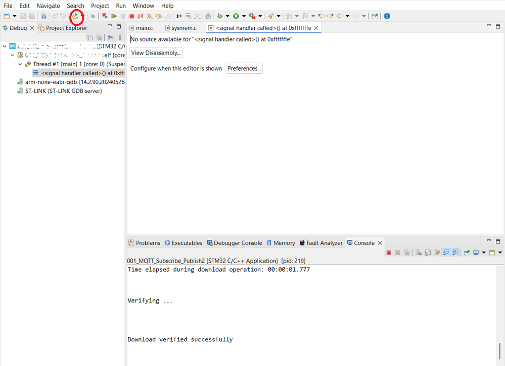

Dear @Shreayas_Acharaya ,
You can not boot at sector5 on this product, impossible , it is hardware coded to either Flash sector 0 or ST system memory boot .
So, if you want to do that , you need to program a Jump code from Sector 0 to sector 5, therefore programming First boot sector at 0x0800-0000. When using debugger , the debug is forcing that jump automatically but this will not happen at standalone after cold reset.
Cheers,

Did you set the vector table according to that new address?
Did you update the linker file according to that new address?
2025-05-16 6:15 AM
Yes i done these steps:

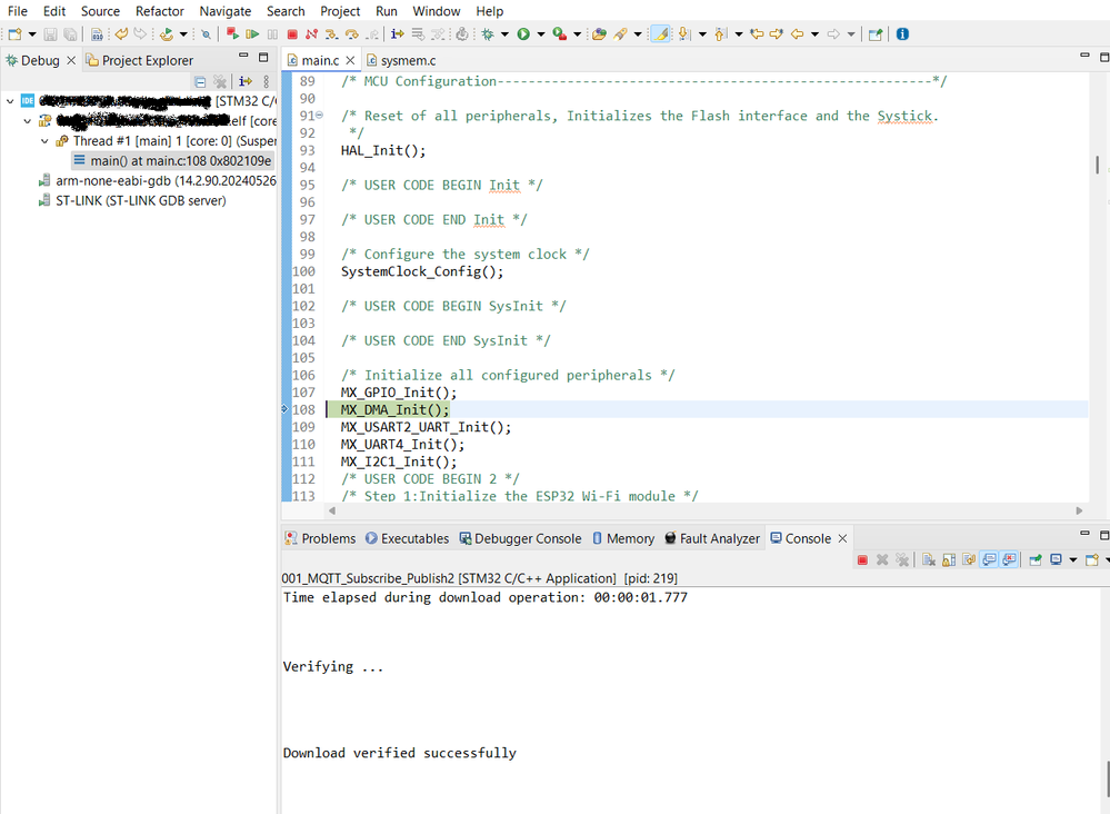

2025-05-16 11:44 PM - edited 2025-05-17 12:23 AM
Another thing to note:
In debug mode, when I hit "Resume", the code runs as expected.
But if I hit "Reset", it doesn't run and shows a message like “No resource preset” or gets stuck.

I placed the code succesfully @sector5 (i.e., 0x08020000) , but it runs only once , after reset it doesn't run.
