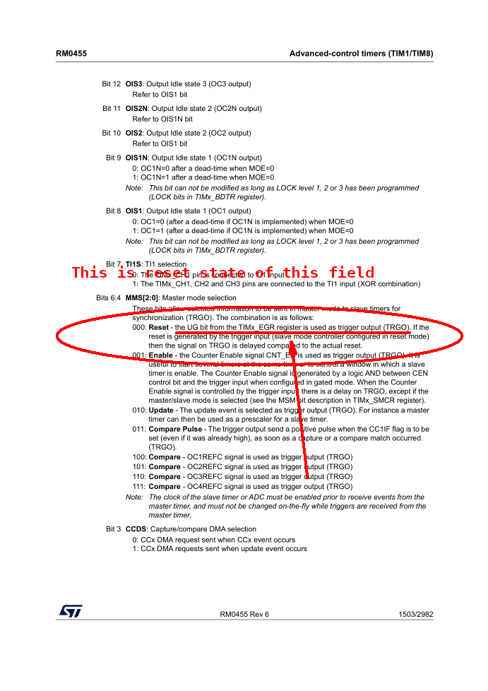

In STM32H7B0xxx platform, I use TIM8's TRGO2 to trigger ADC2 converstion.
In the MX_TIM8_Init() function, it will generate an update event and fire a TRGO signal unexpected before TRGO2 source initialize.

After tracing the HAL code, I find that at the time of software generate update event, all the trigger sources are in HW reset state. TRGO/TRGO2 trigger event sources have not been configured but trigger signal exist on TRGO/TRGO2.
I want to know who generate it ? how to avoid?
lafa
Only initialized timer Clock Division,ARR, counter mode, then raise an update event, I get TRGO/TRGO2 trigger.
Got it. Thanks a lot.
It means at the HW reset state, timer will generate TRGO signal whenever by UG event.
