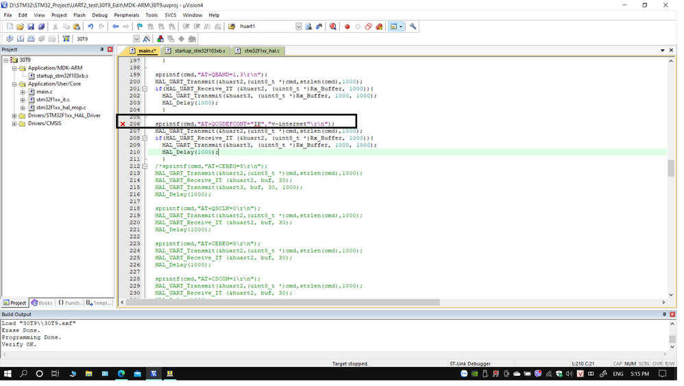

0693W00000GY0gTQAT.pngI am having a problem with this line. When i use sprintf to send command but in this command have "", so this line is error. I want to some advice and solution to this.
Thanks
Double quotes within strings need to be escaped. You need to add a backslash before them.
sprintf(cmd, "AT+QCGDEFCONT=\"IP\",\"v-internert\"\r\n");

try to use below.
sprintf(cmd, "AT+QCGDEFCONT=/"IP/",/"v-internert/"\r\");
Thank you very much, i have try this but it seem isn't correct too, this below is error code
Thank you very much. I have understanded.
